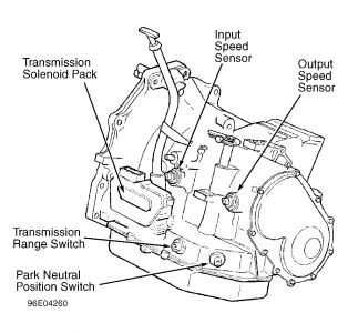

Check for codes
suspect input and out put sensors
and or solenoid pack on the side of the tranny
