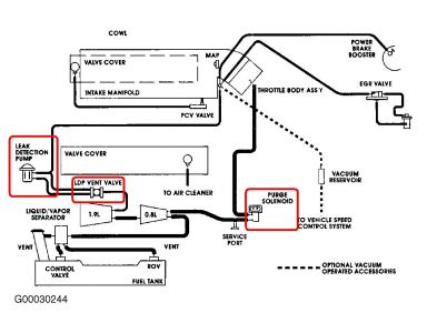

P1455 Evaporative emission control system leak detected (gross leak / no flow)
Usual trouble areas are highlighted.
