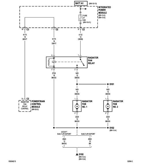

It sounds like you are losing connection or the computer is not giving the command to close the relay. Lets use a test light to check the triggers and grounds.
Here is guide and the wiring diagrams to help you test the system:
Check out the diagrams (below). Please run this test and get back to us.

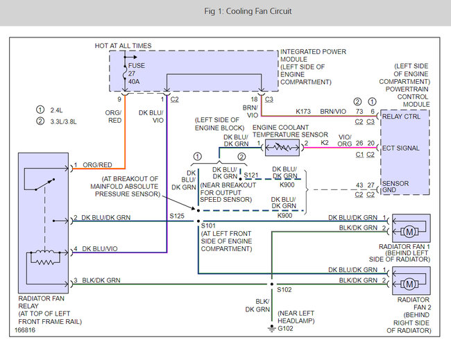

My van fans will not run unless you unplug the coolant temperature sensor. Here is what I have done so far:
Replaced relay behind bumper.
Checked all other fuses and relays.
Replaced coolant temperature sensor twice.
Replaced pressure transducer.

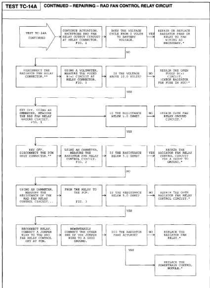

I have checked all wires at relay. I have power, ground and signal.
The fans will run when I jump the relay harness.
The fans will run when you unplug the coolant temperature sensor.
The fans will not run when AC is on.
The fans will not run when the engine reaches the temperature in which the fans should turn on.
Help!

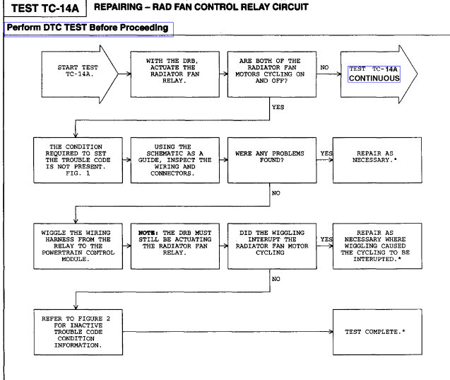

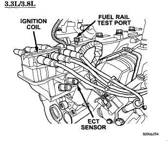

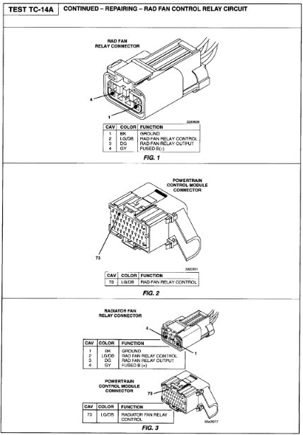

Hi and thanks for using 2CarPros.com. It sounds like you have already done a lot of work trying to fix this problem. What I have done is this. The first picture I have attached is the coolant temperature sensor location. There are two coolant temperature sensors on this vehicle. One is for the gauge, the other is for the computer. Check to make sure you are getting the correct one.
Next, the second picture is a flow chart for checking the fan relay. The chart is specific to this vehicle and should help you find the problem. Please keep in mind, you mentioned in your post that you have power, signal, and ground. If that is the case, it should work. Something is happening when power is sent, otherwise the fans would work.
Check out the flow chart and let me know if you find the issue.

Radiator cooling fans do not work. I replaced the fuse for the relay and relay shows it works too. I am trying to locate the temperature sensor that tells the fans to turn on. Cannot find it.
Dec 21, 2020 at 9:49 AM (Merged)
  • CAR REPAIR CONTRIBUTOR
Good afternoon.
I attached a wiring diagram of the system. Check the fuse listed for power on both sides with the key on.
The engine coolant sensor is what sends a signal to the PCM. Based on that reading it will ground the control side of the relay and turn on the fans.

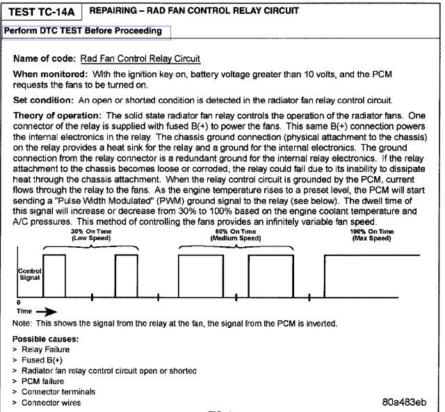

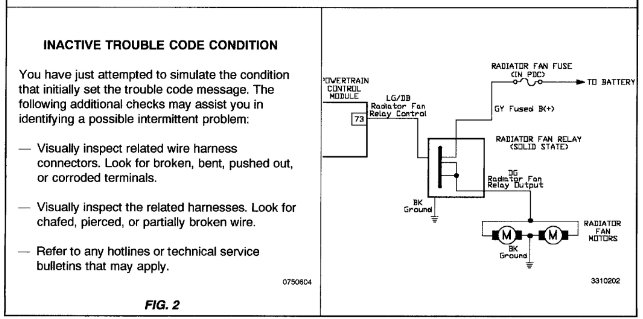

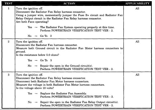

Hello, I have just recently had an overheating issue with my van sitting on idle. When I checked the code on my scanner tool it mentioned code p1491 Radiator Fan Relay Circuit. I have replaced the relay and yet I keep getting the same error code and fans will still not turn on. I have checked and tested the fans(both worked but replaced them anyways). I also checked the relay for continuity, all is good. Last, I replaced the coolant temp sensor since the plastic was broken but even then the fans wont turn on. Other things i have tried was letting the car run to 221°F and disconnecting the coolant temp sensor but nothing seems to work and I still show the code P1491. What else can i do to get my fans working?
DANNY L
  • 5,648 POSTS
Hello, I'm Danny.
I've attached below step-by-step diagnosis/test instruction pictures below for that code.It sounds like you might be having a wiring or PCM problem. Let me know what happens after testing.Hope this helps and thanks for using 2CarPros
