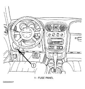

The lights ariund the speedodmeter,fuel gauge and the shifting indicator betweem the seats have gone out. Is this a fuse problem and if so which one?

Use a test light to check fuses turn lights on and check fuses fuse #S 1 ,8,19and 20 located lower left front of dash
https://images.2carpros.com/forum/automotive_pictures/99387_1_24.jpg
