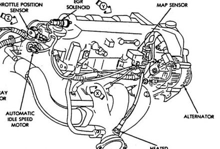

1993 Chrysler New Yorker runs good thin just dies,looses al
1993 CHRYSLER NEW YORKER
70,000 MILES • 6 CYL • FWD • AUTOMATIC
GREENHORNIT

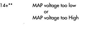

checked fuel pressure-ok fuses and relays-ok trouble codes, 1-2,1-4,5-5. Starts back up in few min.might run 50 miles or 10 foot.My daughter needs car for work badlly. thanks

3.3, check the map sensor circuits and vacuum source. May not be the problem, but, a place to start.
