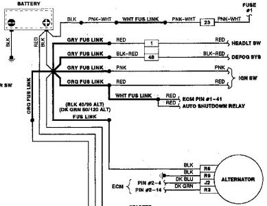

My son's Chrystler Labaren 89 2.5 turbo is losing charge causing lights to dim radio shut off ect. New battery and altenator. ground wires also checked.

new alternator but is it charging check fuses and relays check wiring at the back of alternator

good luck[/quote:b23d2a6344] narrowed it to voltage regulotor- i think-which is in the computer-now it's putting out too much -no idea where to go from here. about had enough!

good luck[/quote:4f03aa8fa7] narrowed it to voltage regulotor- i think-which is in the computer-now it's putting out too much -no idea where to go from here. about had enough![/quote:4f03aa8fa7] yes the computer is responsable for regulating the system good luck
