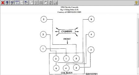

What is the firing order for 3.5 V6 engine in the 1994 Chrysler Concorde. I need a diagram for spark plug wiring.
Wednesday, January 28th, 2009 AT 7:44 PM
MECHANIC
75,992 POSTS
Here you go check out the diagrams (Below). Please let us know if you need anything else to get the problem fixed.
