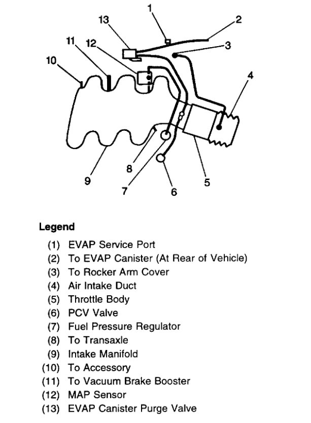

Ok first I have a overheating problem well I did a couple things ive put it back together and now I believe I did not connect the vacuum lines correctly it shuts off right away
Aug 21, 2020 at 11:53 AM (Merged)
  • CAR REPAIR CONTRIBUTOR
  • 54,354 POSTS
It sounds like you have a vacuum leak. here is a guide to help you find it with the vacuum hose routing diagrams:
Check out the diagrams (below). Please let us know what you find.
