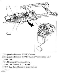

I have a code p0449. The test person said to blow the evap vent line out with air. May have dirt in it. Cannot find vent line.

The def for your code is...
P0449 Evaporative Emission Control System Vent Valve/Solenoid Circuit Malfunction
And the location is over top of the gas tank check pic below....
