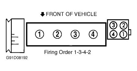

2.0? if so here it is.
https://images.2carpros.com/forum/automotive_pictures/62217_Firing_Order_1.jpg
