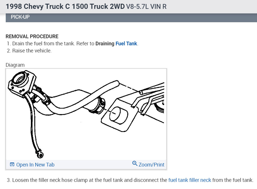

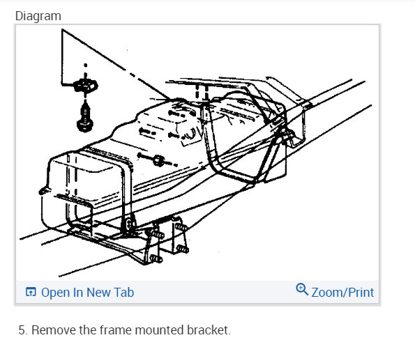

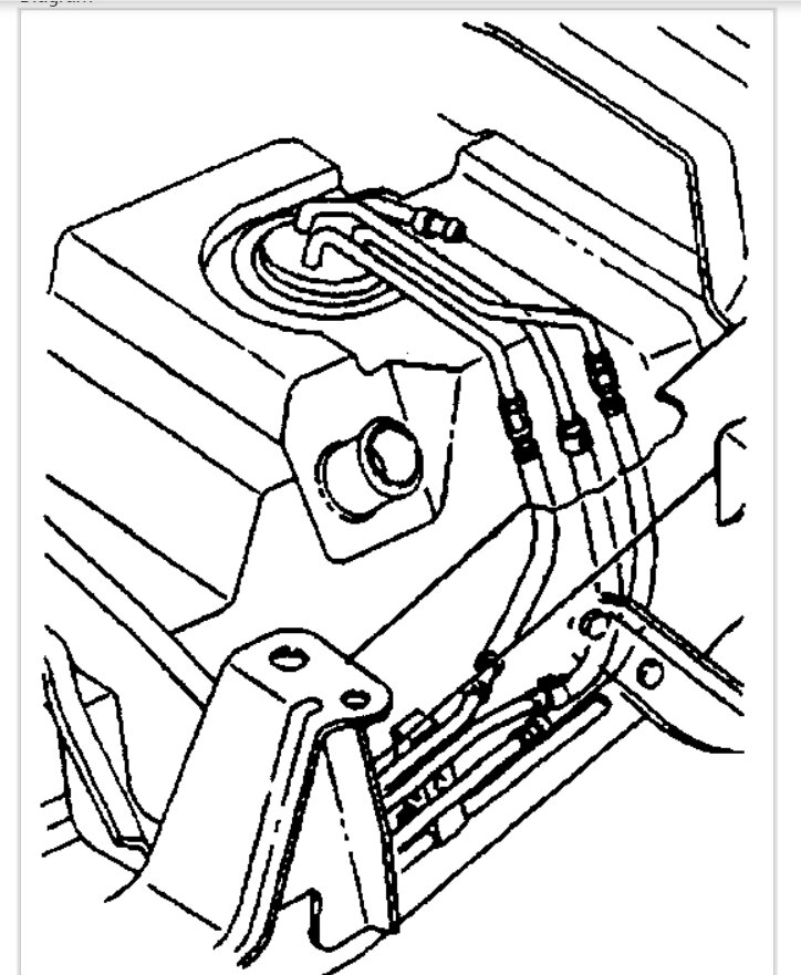

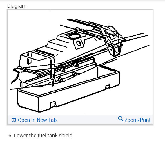

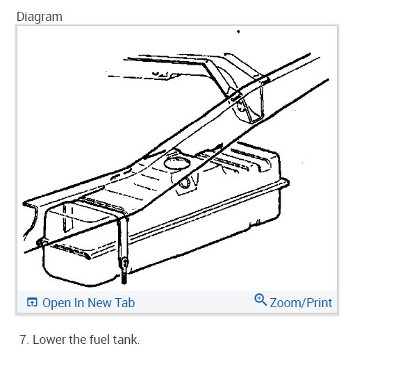

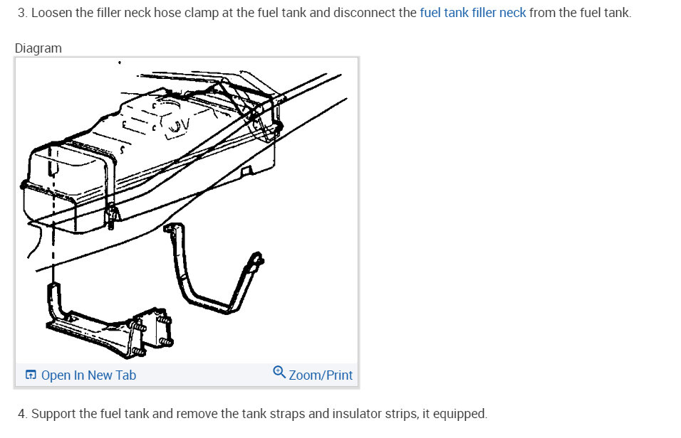

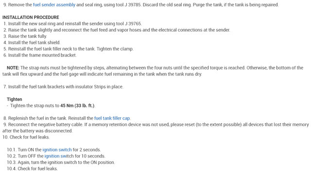

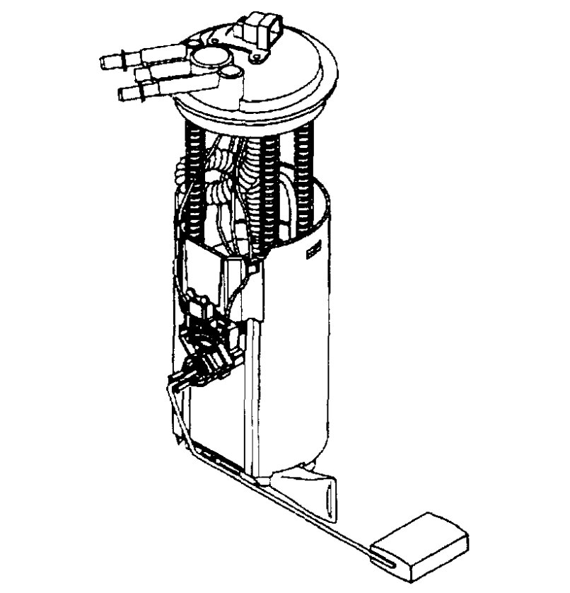

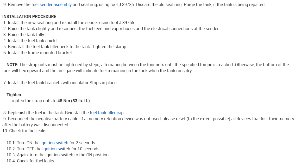

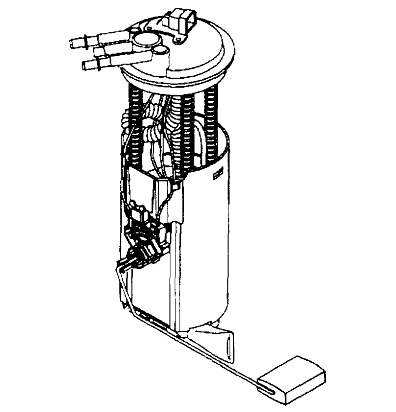

I would swap out the fuel pump which go out all the time in this truck, here are the instruction in the images below to show you how to do the job. Drain the gas out first, this video will show you how.
https://youtu.be/Q5MH2gnyFH0?si=pauM-Va1R5MIVier
