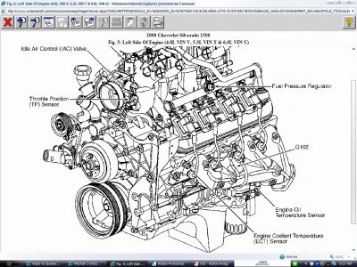

When starting on a cold morning my engine idles very rough (high to low surging) almost to the point of shutting down. I will use the foot pedal to maintain ~1500 rpm for a minute or so until the engine maintains idle on it's own. After beginning the trip the engine runs fine. The truck has been running fine since purchasing new. I gave it an engine tune last year. Thanks for your help.

Check your ECT, that's the engine coolant temp sensor...it acts like a choke for FI vehicles...
https://images.2carpros.com/forum/automotive_pictures/62217_2000ECT_1.jpg
