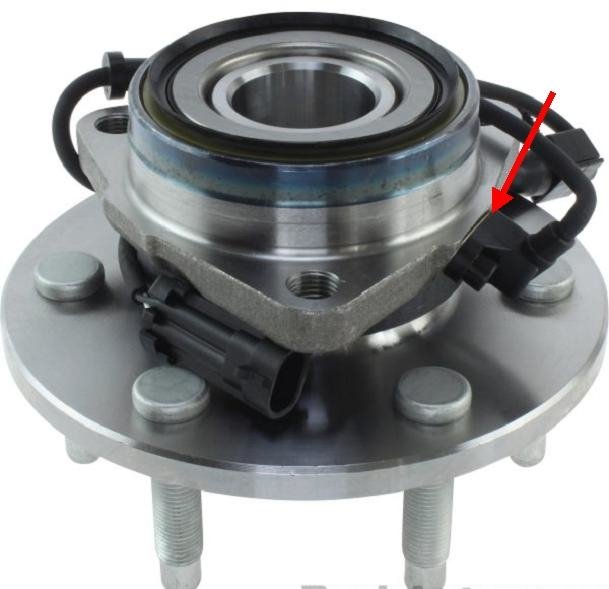

CARADIODOC
  • CAR REPAIR CONTRIBUTOR
  • 34,309 POSTS
Extremely common problem on GM trucks. This is called "false activation". Due to their design, the wheel speed sensors develop rather wimpy signals, and since relative speed between the sensor's coil and the disturbed magnetic field affects signal strength, at lower speeds the signal drops too low for the computer to be able to read it. It sees that as that wheel has locked up, so it tries to modulate brake fluid pressure in a misguided attempt at getting that wheel rotating again.
Another variable in the strength of the signal is the air gap between the tip of the sensor's magnet and the rotating toothed tone ring. The problem you're experiencing is caused by rust build-up under the sensor that pushes it outward, away from the tone ring. Add in the weaker signal as wheel speed slows down, and the signal drops too low before the truck comes to a stop.
You could solve the problem by replacing both front wheel bearing assemblies, but it is faster and just as effective to remove the sensors and scrape off the rust.
The first photo shows the bearing assembly as you'd pull it out of a box. The second one is of the sensor unbolted and pulled out. The blue arrow shows where the rust develops that pushes the sensor away from the tone ring. As long as it is removed, clean off any rust or metal filings that are clinging to the magnet at the red arrow. That can also lower the strength of the signal.
If you want to do this yourself, start with this article, but it's the video at the end that pertains to this service. You'll see how to start the process of removing the wheel bearing assembly, but you don't have to go that far. Use this to see how to get down to the wheel speed sensor.
Even better, check out this video:
https://youtu.be/ZgiPRG6jffc

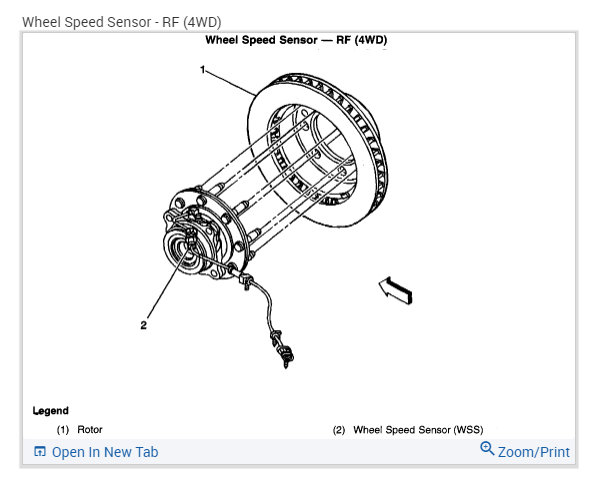

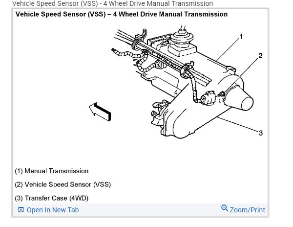

More than likely you have speed sensor that is not reading properly. So when you slow down it is telling the ABS that one is moving faster or slower than the others and the ABS thinks is it slipping and activates the ABS event.
We need to check for codes and then monitor the wheel speed and vehicle speed sensor and look for which is different. You will need a scan tool to do this. If you don't have one, just have a parts store check for codes and we can go from there. Thanks
