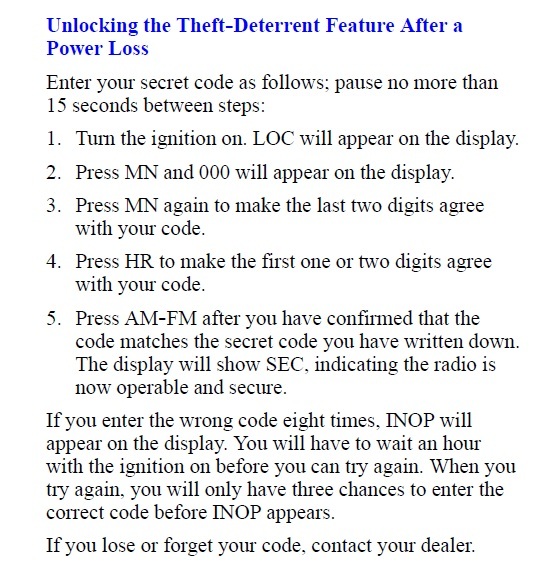

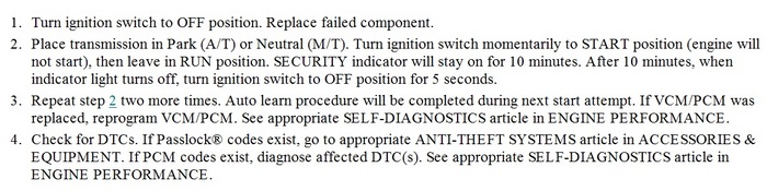

I have a 2001 chevy s10 blazer. I removed the battery and several hours later I replaced it. Now the security light on my dash keeps flashing, the radio is in LOC mode and it will not start. Do I have to reset the fuel pump relay or is it something else?

You can try the procedure below for passlock security, to see if vehicle will start and run.
The other procedure is for radio loc, without that code, you may have to contact dealership.

I've been having problems with my truck. Sometimes it will start fine and other times it won't start at all. The security light sometimes blinks on the dash. Is this a passlock security problem? If so, how do I fix it, if not what could it be?

Yes this is pass lock problem. Ive been changine alot of ignition cylinders lately. You need to bring you registration, drivers license to dealer to get parts. Once you replace cyl you must reprogram the new parts, its easy. Let us know if your going to do this and we can walk you through reprogramming sequence.
