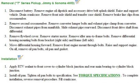

How do I remove the oil pan on an1995 chevy blazer
Sunday, January 4th, 2009 AT 7:53 PM
BLUELIGHTNIN6
MECHANIC
16,542 POSTS
Hello
Below is info. you requested.
TORQUE SPECS.
Hope this helps..
