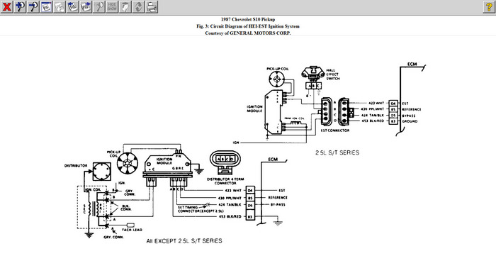

I have a 87 chevy s-10 with the 4-tech 2.5 engine I have spark but no injector pulse I have changed the hall effect switch, ignition module and ecm to no avail, I have also checked my wires going from injector to the ecm and all checked out. Also I have power at injector and plenty of fuel pressure. the only problem I have found is I dont have 10 volts at the p term on the module, but as far as i know that should just not get spark but i am. at this point I am getting frustrated the only thing I can think left to check is for a tach signal getting to the ecm can any one tell me which wire i am looking for and what I should be getting when i check? PLEASE SOMBODY HELP ME!!!!

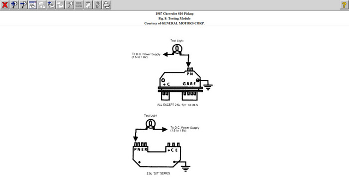

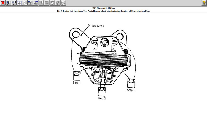

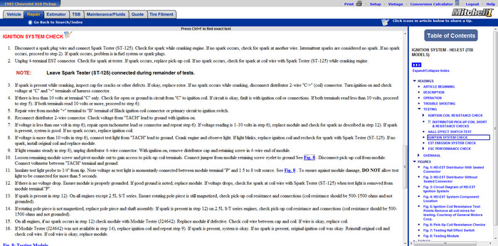

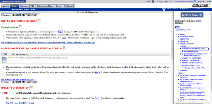

if you knew what type of diode was supposed tobe there you could just go to a place like radio shack and replace the diode. I am sending along pictures and info on how to physically check this system including coil. Hopefully this iwll help find yoru problem. sometimes the diode should be checked with voltage not ohms.

one other thing, here is the only diagram i've found of your system due to age of vehicle. also make sure when the module is put in the distributor that you use dielectric compound on the metal part that touchs the dist.
