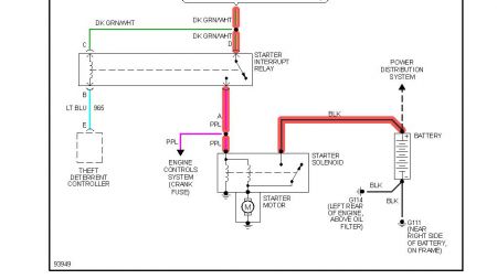

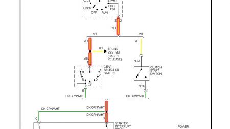

Car will not start when ignition key is turned on. Battery is new and fully charged. Cleaned cable terminals to remove corrosion. Still won't start -- doesn't make any noises.
Jun 24, 2008 at 10:55 PM
  • CAR REPAIR CONTRIBUTOR
  • 75,992 POSTS
Possible causes: Ignition switch, gear selector switch, starter relay, ans starter itself- Have helper hold key in start position look for power at the puirple wire on the starter solenoid-Power there replace starter-No power see below
