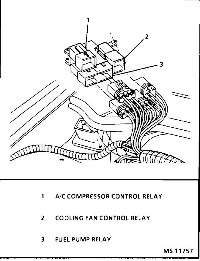

I need to know the exact location of the fuel pump relay on a my car. Lt 3.1 liter.I put a new fuel pump in but I am not getting any fire going to it so I may need to replace the relay and I need to know where its located please

Its mounted in the engine compartment, by the firewall in a relay pack
See the diagram below for location

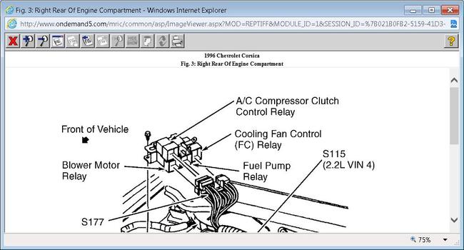

I know that the relay is located on the firewall behind the right shock tower, but, which one is it? There are four relays on the bracket & I had someone turn key on while I felt for one to click. Well, 2 of the damn things clicked, so now I'm confused as to which is the correct one. I've looked online, Haynes manual, & neither is definitive as to which one of the four is the correct one. Since I at least have it narrowed down to two possibilities, I guess I could just use process of elimination, but if you can tell me exactly which one, it would be very appreciated! Thanks, SEABEE

Which relay are you looking for?That would really help since you said there are four of them.

Here you go.

Thanks Saturntech9! I am looking for the FUEL PUMP RELAY & they are all in a straight line on the bracket, NOT like the layout on the diagram you just sent, but THANKS anyway!

Which engine do you have?
+1
Wednesday, March 6th, 2019 AT 6:18 PM (Merged)
SEABEE1
  • 7 POSTS
2.2 4cylinder

The fuel pump relay has a dark green wire with a white stripe a black wire with a white stripe A gray wire and a pink wire. That should help you find the relay.

Got it! Thank you very much! You've been a big help!
