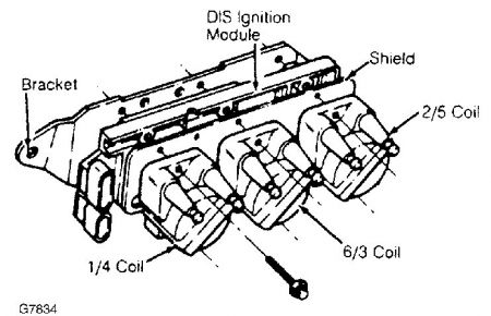

my 1987 cavalier z24 has the 2.8 6 cylinder motor i recently installed a new transmission filter gasket fluid as well as a new thermostat 2 weeks later my car starts i drive approximately 1 mile the motor shuts off just as if i turned the switch off.i thought it may have been the coil packs so i changed them but the same problem occurred so my question is what could possibly be the problem?

I would be surprized if it was the pump, but you can try 2 things when it happens regarding the pump. 1- bang on the bottom of the tank while cranking. 2- spray some starting fluid in the throttle body, then crank it. I would lean more toward the ignition module or crank shaft sensor.
https://images.2carpros.com/forum/automotive_pictures/30961_mod_1.jpg
I may be wrong, but I think the crankshaft sensor is on the flip side of the ignition module and is common for cracking. I believe also that there are times when they are cracked the the module is being removed that a piece of it can fall into the motor in which case the oil pan has to be dropped to get it out. If I am right, I would change the crankshaft sensor at the same time as the ignition module as it is such a joy to get in there.

i do not think it is the gas pump for 1 reason when the vehicle shuts off i checked to see if it was firing and there was no sparks of any type from either of the coils that was the reason i changed the coil packs now the exact same situation occurred the fuel pressure release valve by the fuel injector body sprays gas very well .therefore i would honestly think it is something other than the fuel pump. it seems like it has to be in the ignition and firing .how often do those modules go bad?

ok i changed the ignition module and coil packs the car starts, runs, shuts down does not start back.so what else could be causing this vehicle to fire up then stall out then lose all spark for hours before restarting?
