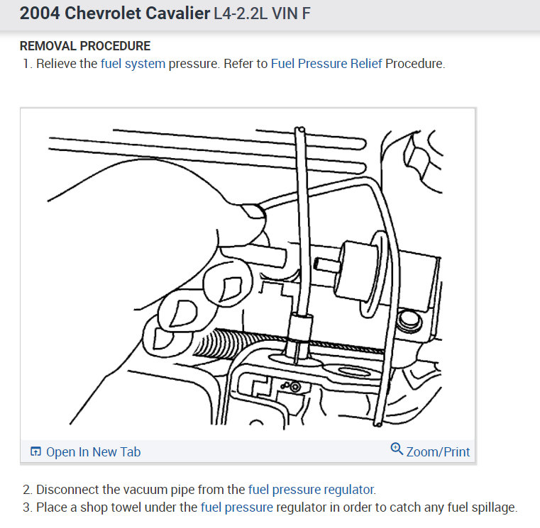

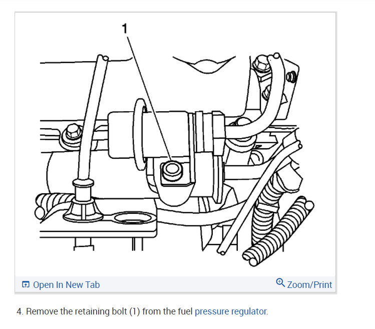

I've been smelling gas from the front of my car for about 4 weeks now. Finally found out where the problem is. The fuel pressure regulator is leaking gas and it is causing my gas mileage to be very low. I know I need to relieve the fuel pressure, therefore I would need to locate the fuel pump relay and disconnect it. Now my problem is finding a better description on exactly where it would be, because I cant read schematics to well. So where would this be located?

Every service manual describes how to relieve fuel pressure but we rarely do that. When customers are paying us by the hour, we don't have time to spend on things like that. There isn't that much fuel that's going to spray out, especially when the regulator is already leaking. The same is true when replacing fuel filters. We just pop a hose off and let the fuel run on the ground. You'll only get a few tablespoons. You can also look for a fuel pump fuse. Remove it, then try to start the engine. You can also look for a pressure test port on the fuel rail and use that to bleed off the pressure. Check out the diagrams (Below). Please let us know if you need anything else to get the problem fixed.

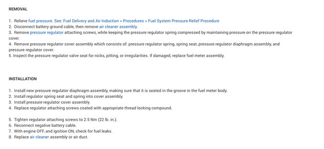

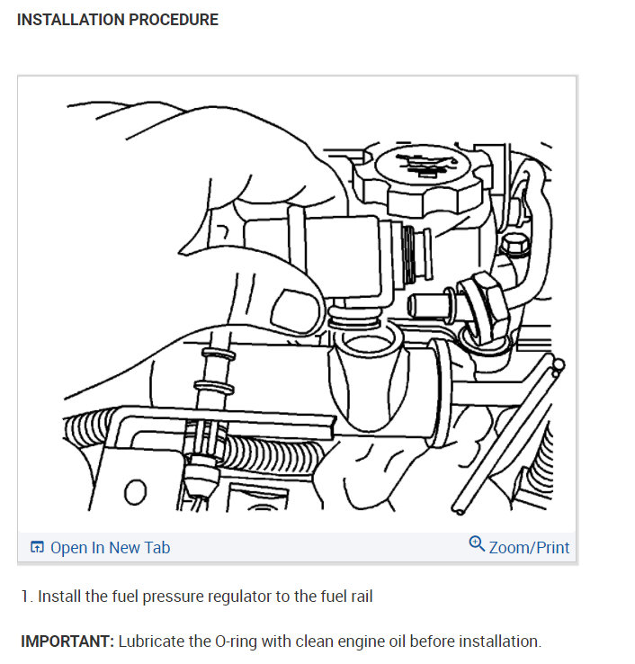

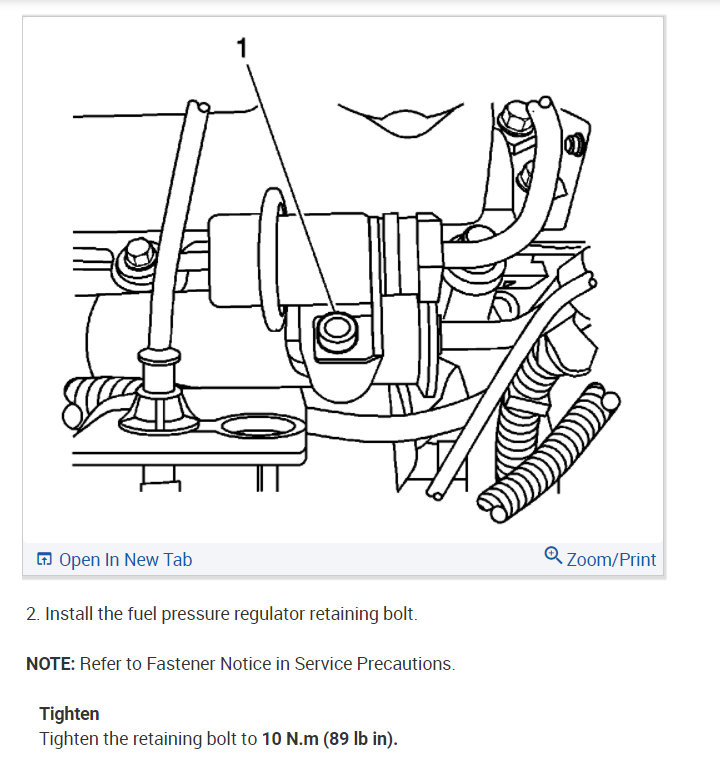

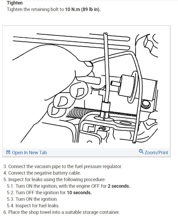

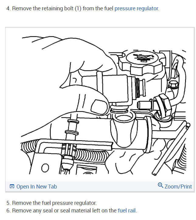

How can I remove the screw from the brackets the bottom) on the fuel pressure regulator. I am attempting to change or replace the fuel pressure regulator. I have already removed the side torx screw attached to the bracket.
Wednesday, May 12th, 2021 AT 7:01 PM (Merged)
  • 108,328 POSTS
Relieve the fuel system pressure.
Disconnect the negative battery cable.
Remove the vacuum hose from the regulator.
Place a rag under the connection and remove the fuel return pipe clamp.
Remove the fuel return pipe and O-ring from the regulator. Discard the O-ring.
Unfasten the pressure regulator bracket attaching screw, then remove the pressure regulator assembly and O-ring. Discard the O-ring.

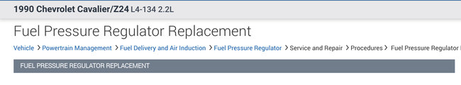

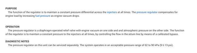

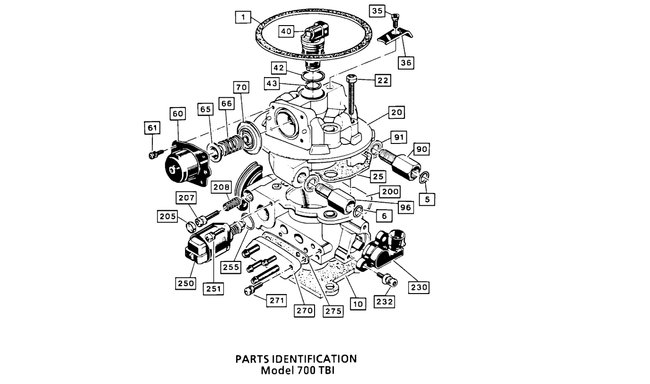

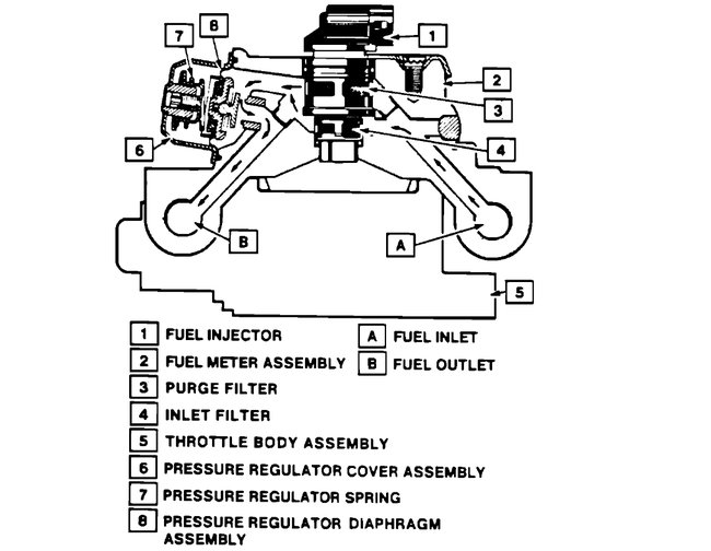

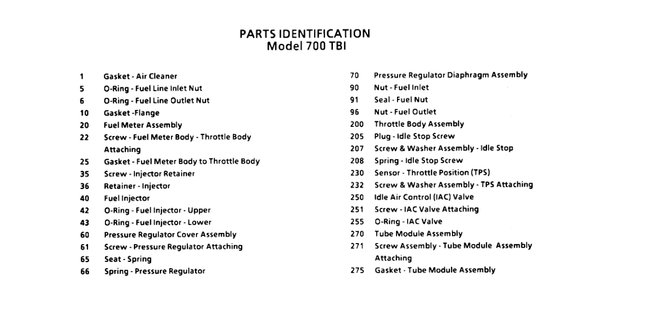

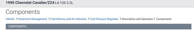

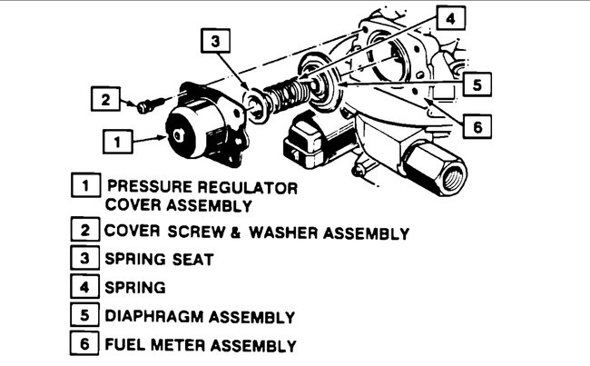

I cannot seem to find an exact diagram for this engine, it’s the TBI so I don’t know if it’s the throttle body itself or what! Any help is much appreciated!
SCGRANTURISMO
  • 4,897 POSTS
In the diagrams down below I have included the description of operation and the instructions for the removal and installation of your vehicle's fuel pressure regulator[including a diagram of it's location] from the vehicle manufacturer for you. Please go through this guide and get back to us with how everything turns out, and I hope that this helps out.
