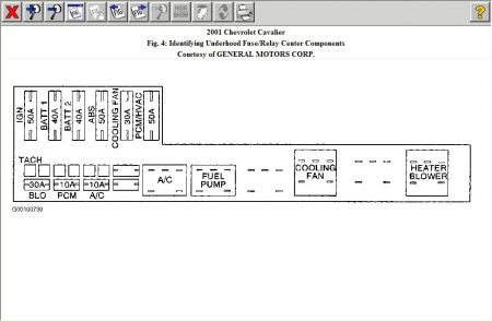

When starting, the starter turns the engine over and the engine engages for 1 to 2 seconds and then dies. We had the battery replaced and started fine - for about two weeks. Then the car would do the same thing - starter turns the engine over and the engine engages for 1 to 2 seconds and then dies. We replaced some wire going to the module and started fine for about two weeks. We replaced the entire module (with a used one) and started fine - for about two weeks. We replaced the key cylinder and the same result - worked for two weeks. We replaced an (I believe) ignition switch and the same result - worked for two weeks. Any thoughts? Thank you for your time and input...greatly appreciated!

The problem seems to be an intermittent power supply interruption and the circuit is from the BATT 1 Fuse (40A) underhood. Check for poor contacts of fuse and wire harness connectors under fuse box. Look out for signs of overheating.
https://images.2carpros.com/forum/automotive_pictures/192750_FuseBox01Cavalier_1.jpg
