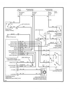

My car is not equipped with cruise control and I was wanting to know if I could take off a cruise control from a 98 pontiac sunfire and put it on my car and also what parts would i speciffically need to take off?

If you have the wiring wiring is very important before any worl make sure u have it parts needed cruise control brake switch also if standard cruise control clutch switch cruise control module multifunction switch and make sure its all wired u need the PCM to control it and speed sensor out put good luck
https://images.2carpros.com/forum/automotive_pictures/99387_cruise_1.jpg
