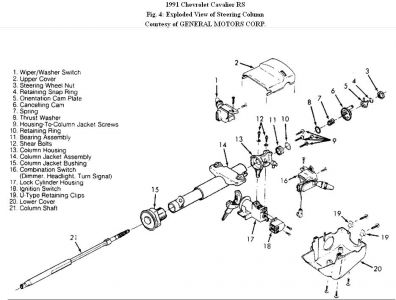

I was just given an answer to a previous question which stated that the problem I was having could be rectified by replacing the ignition switch. I am fairly mechanical but have never done this before. Is this a difficult task? I have the part and installation would appear to be pretty staight foreward. Any suprises I should consider before tackling this myself? Thanks for your time.

Hi mbush2583, Always reply to the same post in order for notification to be forwarded to the person attending to you and resp[onse. A new post might take a longer time to be noticed and even missed. Replacing the ignition switch is not too difficult. IGNITION SWITCH Removal 1.Remove steering wheel. Remove upper and lower column covers. See Fig. 4. On models equipped with tilt col-umns, it may be necessary to remove tilt lever to allow removal of covers.
https://images.2carpros.com/forum/automotive_pictures/192750_SteeringColumn91CavalierFig04_1.jpg
2.Separate rosebud fastener of wiring harness from lower column jacket. Remove combination switch to allow removal of ignition switch top screw. Disconnect and shield negative battery cable. Disconnect ignition switch harness connectors. Remove ignition switch from lock cylinder housing. Installation To connect ignition switch to lock cylinder housing, align tab on lock cylinder with slot in ignition switch. Install and torque switch retaining screws to 21 INCH lbs. (2.4 N.m). Install electrical connectors to ignition switch. Install combination switch and torque mounting screws to 49 INCH lbs. (5.5 N.m). Install rosebud fastener and column covers. Torque cover mounting screws to 49 INCH lbs. (5.5 N.m). To complete installation, reverse removal procedure.
