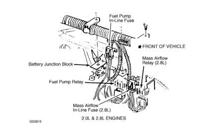

changed fuel pump and ignition control module and found that the fuse for the fuel injector is blown so i replaced fuse and now i find that im not getting any power from the fuse box in only certain areas because some of the fuses still work fine how do i go about fixing the problem before i move on to the next process of elimination? thank you for your time and cooperation sincerly 3bc. P.S.would like to donate but dont have the funds at this time.

I'd check voltage to and from the battery junction block. My info says it is located on the left side of firewall. Check for voltage coming and going. With fusible link, check voltage on both sides of the link.
https://images.2carpros.com/forum/automotive_pictures/170934_cavalier_battery_junction_block_1.jpg

Sorry I don't have a better picture. Mod just says, driverside firewall and gives the picture I posted. One of the wires from the positive battery post should go to the junction block. The databases are not always correct, that's just what it shows.
