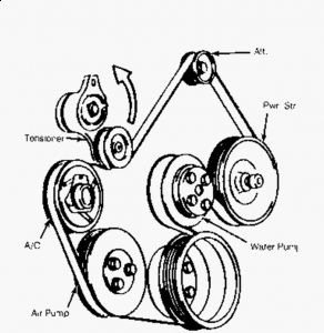

Does the alternator belt run anything other than the alternator on this vehicle?
Tuesday, December 29th, 2009 AT 3:48 PM
MERLIN2021
MECHANIC
17,250 POSTS
If it's a 5.0 or 5.7 it's a serpentine belt, and it runs all pulleys as shown.
