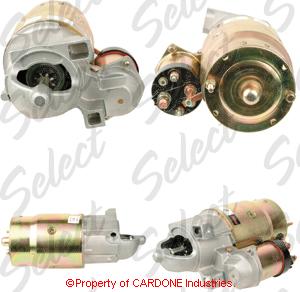

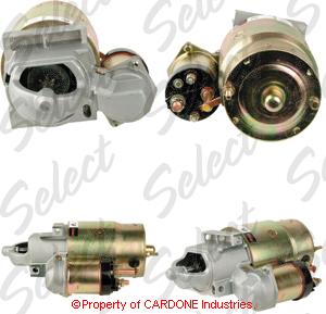

Now start shimming it and get to .060 and your done.[/quote:54da602bfc] rasmataz: You are reading this ... right? If the starter is 'barely' touching the flywheel teeth, then 'shimming' the starter is going to move it farther away, making it worse. As for there being 'only 2 starters that will work' , that's because you're probably telling them it's an 88 camaro .... Do you know what the engine and trans came out of? Another camaro, impala, monte carlo, van .... And did it come out of another chevy? buick, pontiac .... The starter you've probably got right now looks like this -
https://images.2carpros.com/forum/automotive_pictures/30372_393510MSN01_1.jpg
A1 Cardone #39-3510MSN right? ..... Have you tried this one? -
https://images.2carpros.com/forum/automotive_pictures/30372_393838SN01_1.jpg
part# 39-3838SN

Well according to A1 Cardone, the starter you have in there (3733) only came in GM Trucks Whereas the 39-3838SN came in numerous gm cars and trucks from 64 til now. If you look up the 88 camaro 5.7 (350) Automatic starter, 39-3838SN is the number you'll get.....
