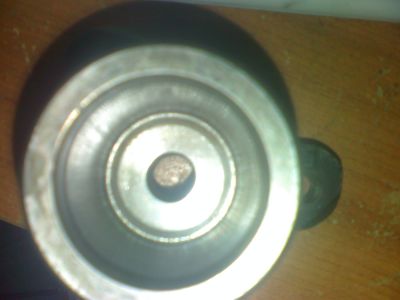

Alright is the mark on the hub that hole it gots? or is it on the outer edge? So to line up this mark im supposed to have the number 1 cylinder at tdc? thanks!

There is a slot cut in balancer mount in you hand. When you had cover off remember see a raised metal strip that the crank gear sliped on? The piece that stuck out thats what you align to slot.
Torque 60-75 ft. Lbs miss typed

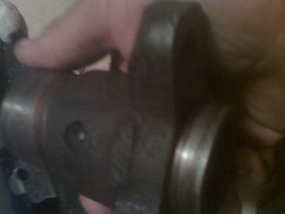

Hey theres no key mark or dent.. I was told the LT1 engine has a press fit crank hub and not keyed. Also the balancing is done on the flywheel/flexplate.

Got it your production date must be late in 94 that's when chenge made. Place engine at TDC cyl 1 then install balance with arrow at 12o'clock position.

Alright thanks. Can you give me some tips on how this hub will go on? I thot it would just slide right in but it wont. I dont want to hammer it on? What do you think I should do? Thanks
Friday, November 7th, 2008 AT 6:26 AM
DOCFIXIT
  • 18,828 POSTS
Harmonic balancer bolts to hub. Line hub up tap with dead blow or rubber mallet until you can thread vbolt then tighten. It will draw hub on.
