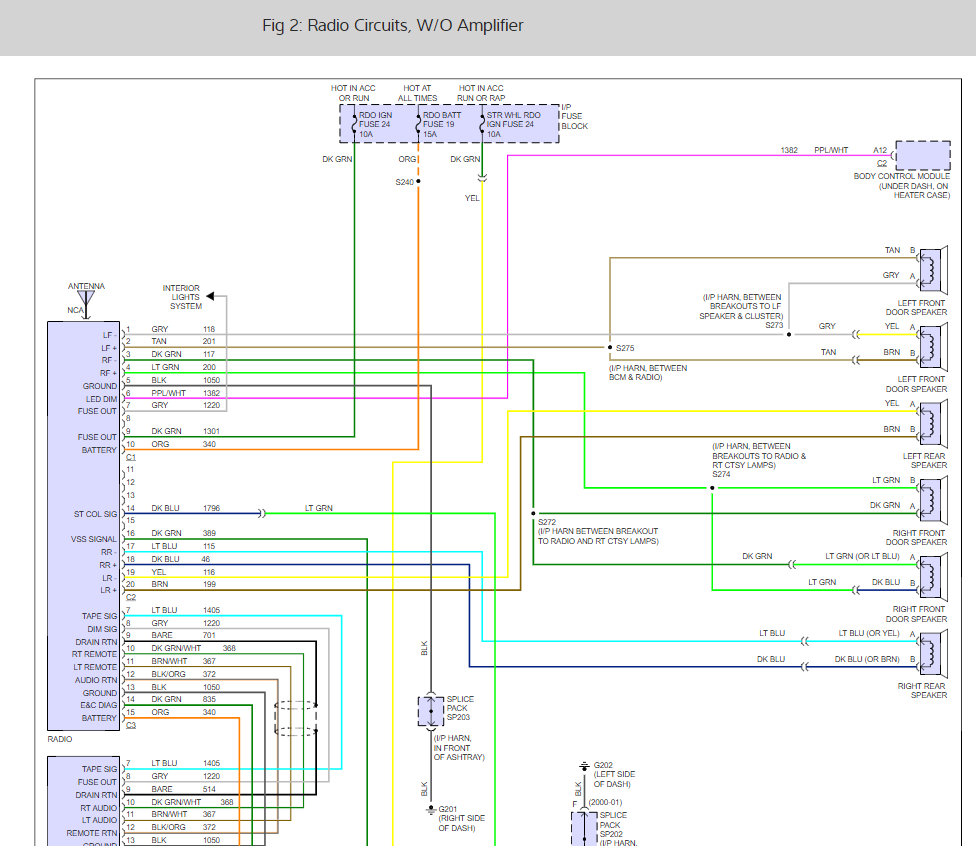

I need the radio wiring diagram for a 2001 Chevy Blazer to an aftermarket radio (eonon 821) thats made in china.
Thanks

Thanks for getting back to me. I have the harness's for both. No one (Audio Installers) has them configured to match, that's why I posted the wiring diagram from Eonon unit. My question is. What do the GM wires hook up to on the Eonon wiring diagram provided.
Please Match this up to Eonon wiring diagram. At this point what I'm requesting should be obvious. Again thanks, I hope this will be answered.

For Blazers and S-10s (including Bravada, Sonoma, Jimmy, Full-Size) the actual stereo wiring is as follows
Constant 12V+ Orange
Switched 12V+ Yellow
Ground Black
Illumination Gray
Dimmer Brown
Antenna Trigger Pink
Antenna Right Front
Front Speakers 4" x 6" Dash
Left Front (+) Tan
Left Front (-) Gray
Right Front (+) Light Green
Right Front (-) Dark Green
Rear Speakers 6" x 9" Side Panels
Left Rear (+) Brown
Left Rear (-) Yellow
Right Rear (+) Dark Blue
Right Rear (-) Light Blue

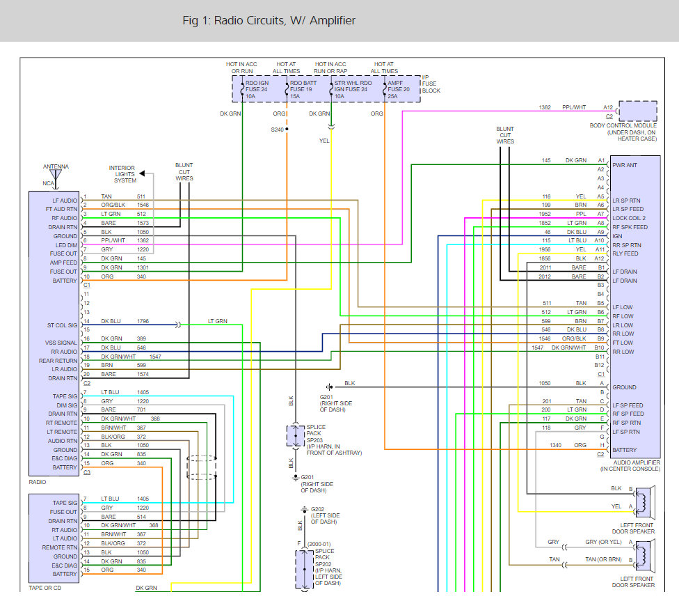

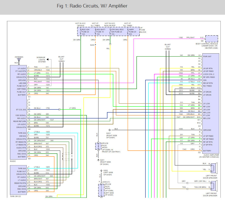

You go to you local stereo shop or Amazon and get a wiring harness adapter kit. This you wire to the stereo and then it simply plugs in. Here are both wiring diagrams for amp and no amp models.

A harness adapter to you do not have to cut any of the cars wiring harness as this will cause problems and be a real mess. The harness adapter should also tell you what wire does what connect them in that manner and then simply plug it into the car. If need be go to Crutchfield on the internet. Here is a pic.

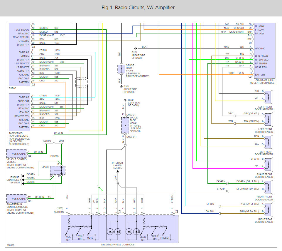

Hi I need to know what colors go with the wiring system for the stereo on a 2001 Chevy Blazer, I'm trying to hook up an amp and sub woofer and need to know the color to cut and add into a high low converter, the color I need is the rear speakers on the back of the stereo.

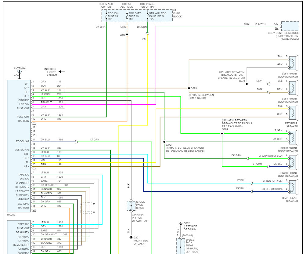

I have found both amp and non amp wiring diagrams for you so you can get the tunes going :) (below) Please let us know if you need anything else to get the problem fixed. (CLICK TO ENLARGE)

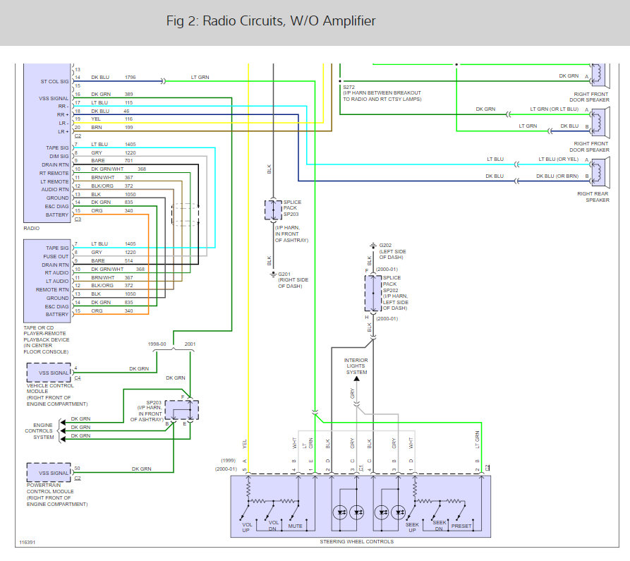

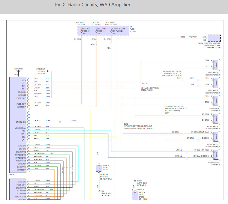

Ok---my 1st diagram is "with amplifier"
the 2nd is without
let me know if you cannot read these---i don't know how they will look on 2car till I submit them.I can help you get them without blurting out your personal info on open forum THE MEDIC

I was replacing the door speakers and needed to confirm + wire - wire for the speakers.

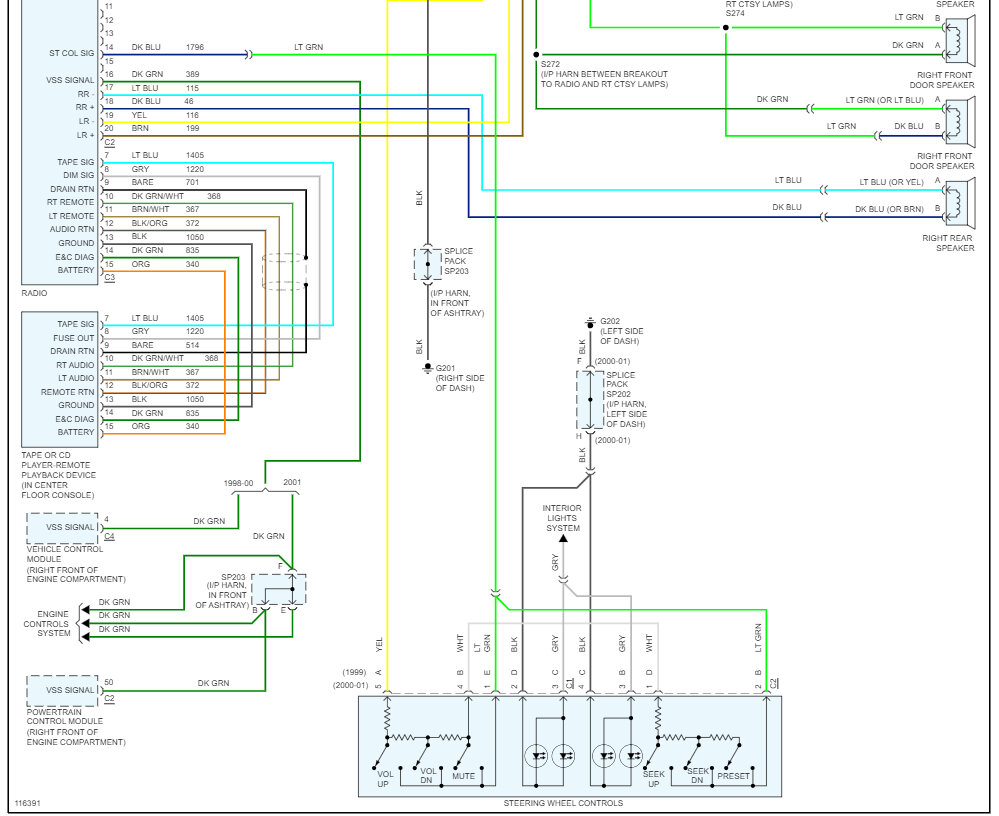

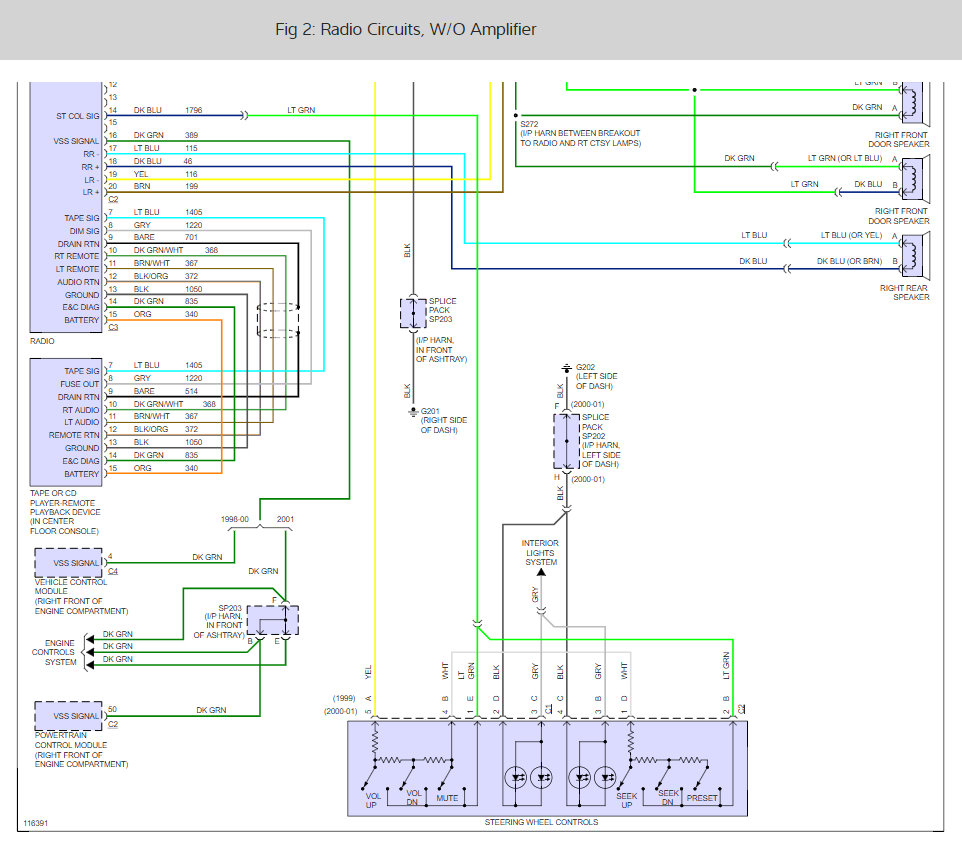

I'm not sure what you are asking, but it is common for people to cut the OEM harness when using an aftermarket radio. Here is the stock radio wiring diagrams. Check out the images (Below). Please let us know how it goes
