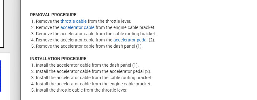

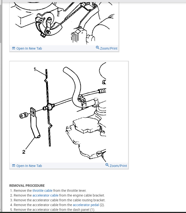

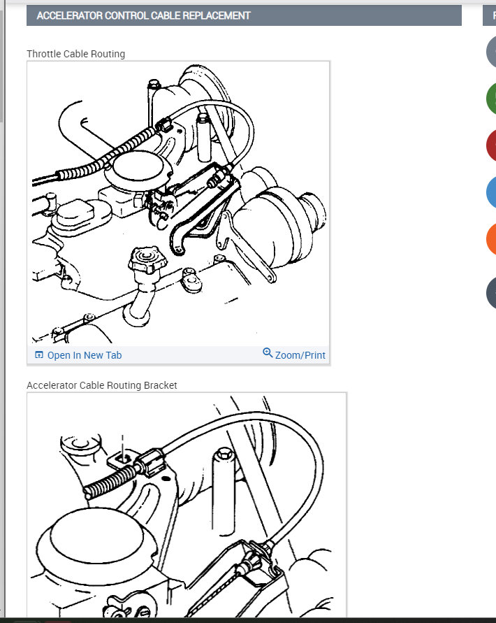

Short answer is yes. This is most likely a throttle cable issue, but we need to start with checking the throttle bore and see if it is dirty. If there is build up on the throttle bore and plate then it can stick and cause this issue so what I would do is change the cable as that is the likely issue, and clean the throttle bore as that will cover all the bases.
Here is a guide that will help with this:
Below you will find the process on how to replace the cable as that is the likely cause and I would highly suggest replacing it.
Let us know what questions you have on this. Thanks
