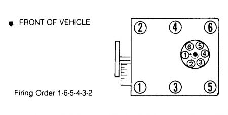

I bought new wireset and put em on. engine was running rough. spit sputterin.
So I took them off, now i can't remember which way
they go back on. iwas wandering if somebody knew
in what order they go back on.like the lengths or something, they're Duralast wires.

https://images.2carpros.com/forum/automotive_pictures/55316_43Lfiringorder_1.jpg
Just attach the wires to the corresponding number on the cap.
