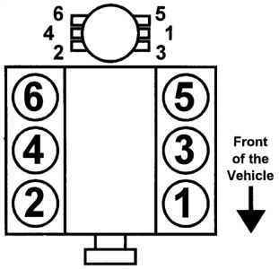

what is the spark plug timming order.
Sunday, March 8th, 2009 AT 5:12 PM
BLUELIGHTNIN6
MECHANIC
16,542 POSTS
Firing order for your vehicle is below..
4.3L Engine
Firing order: 1-6-5-4-3-2
Distributorless ignition system
