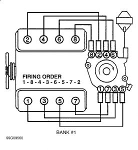

2000 CADILLAC ESCALADE
Need the print out of the firing order
Thursday, August 20th, 2009 AT 2:44 PM
DOCFIXIT
MECHANIC
18,828 POSTS
Here is a picture you will find helpful. Check out the diagrams (Below). Please let us know if you need anything else to get the problem fixed.
