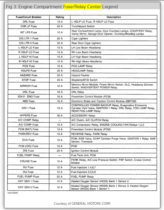

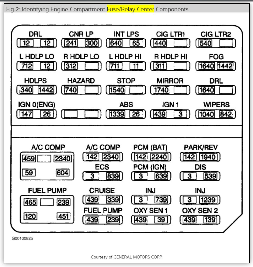

hey i was working on a 1999 caddy deville and replace fuel pump and not getting any fire to the fuel pump. I checked all the relays and the fuse under the hood is there another relay that is some where esle on the car, aiso check the fuses in the trunk , i test the relays with a test light and where the fuel relay goes their is no fire there. dont see any crack wire or any thing do the oil sending unit has any thing to do with that

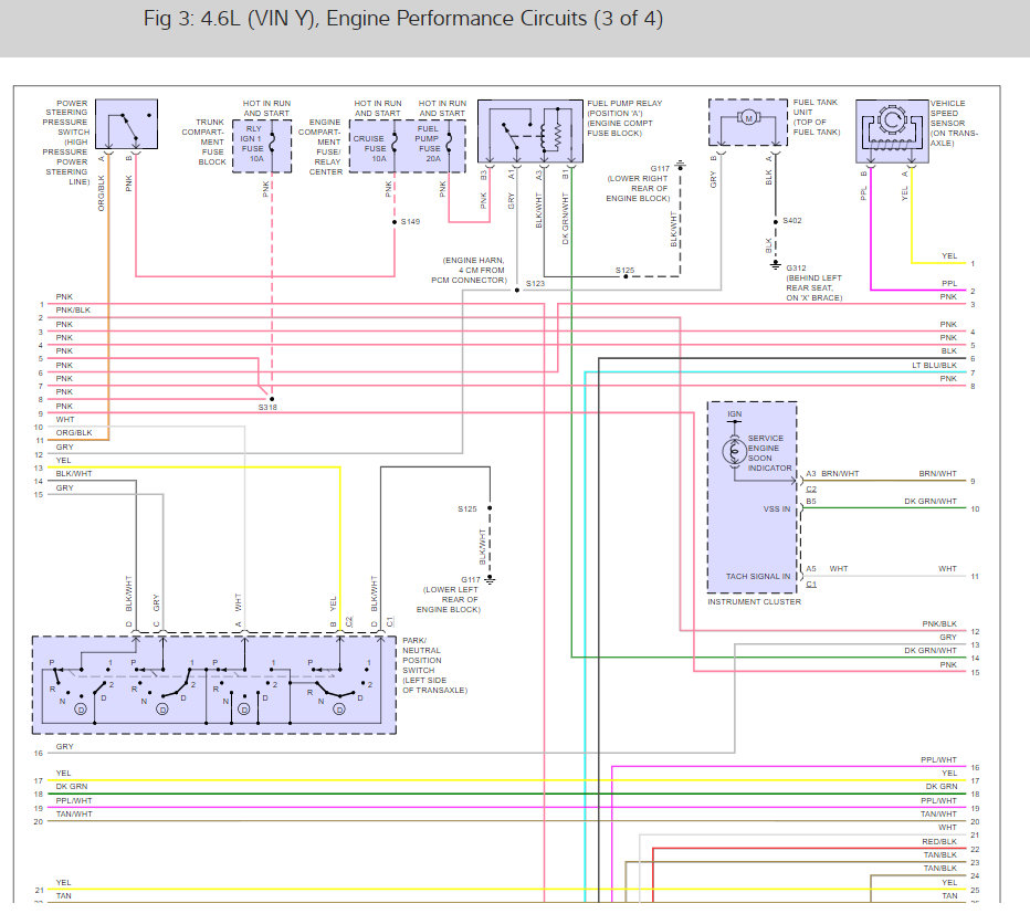

Check the fuel pump relay socket pink wire if there's power nothing here and the fuel pump fuse is good the pink wire is open between the fuse and relay socket

the fuel pump fuse is in the relay panel under right side of dash. 20amp fuse we enjoy your feedback

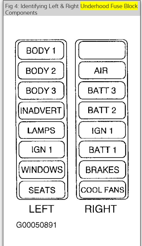

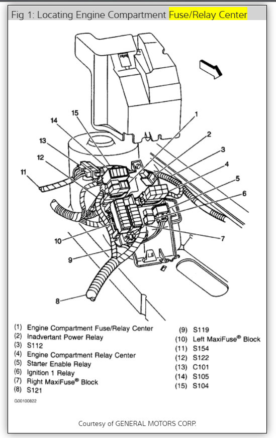

FACTORYJACK
  • CAR REPAIR CONTRIBUTOR
  • 4,159 POSTS
The fuel pump relay is in the underhood fuse block, in front of the left front(driver) strut tower. It is either under the flap that provides access to the mini fuses, or you need to remove the plastic cover. There will be a sticker on the underside of the cover, the legend for the fuse relay center.
May 23, 2020 at 11:44 AM (Merged)
SANCHEZDANNY
found it guys, Thanks! I tried to swap the replays but still won't start. need to have a mechanic trouble shoot the electrical sys. a neighbor said the fuel pump has no power. might be a modulator?

The few seconds is normal as the ECM controls the relay to build rail pressure in anticipation of cranking. Check the fuel pump fuse in the underhood fuse center. If it is blown, you could have a short, but it is more probable that the fuel pump has high resistance and is drawing too many amps and opened the fuse.
  • 54,379 POSTS
hello,
Here is a wiring diagram that show where the power is coming from which looks like a fuse. Here is a guide on how to check for power

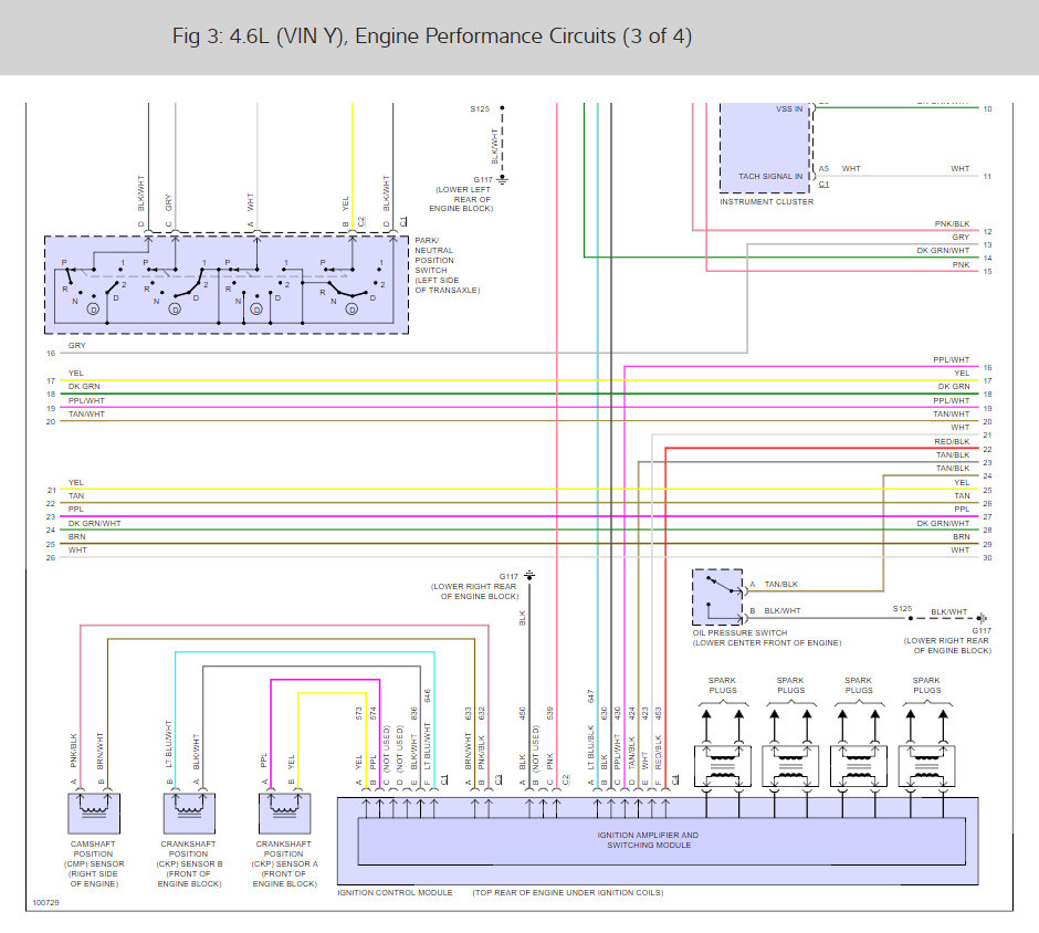

Could be the computer fuel pump control circuit of the relay, also check the oil pressure sending unit.
