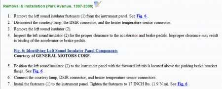

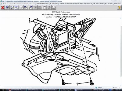

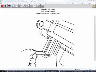

How do I replace the cabin filter - where is it and how hard is it to get at?
Saturday, May 10th, 2008 AT 9:57 PM
MERLIN2021
MECHANIC
17,250 POSTS
Remove the sound panel undewr the driver's side of the dash, then follow these directions...
