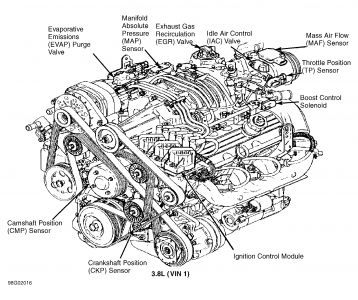

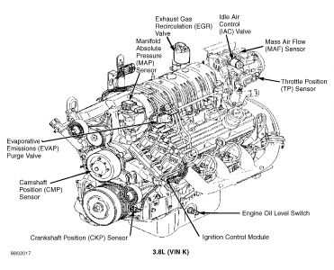

I can't find the camshaft position sensor to replace it.

See diagrams
