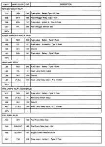

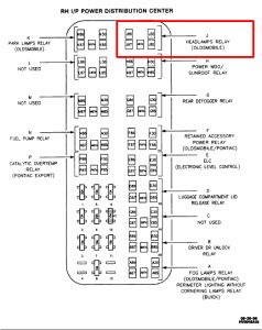

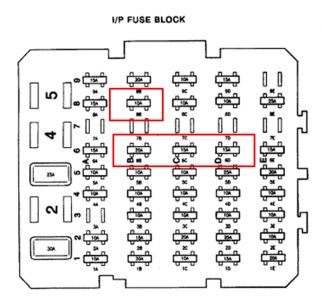

When the parking lights are pressed, they function properly. When the headlights are turned on, all lights fail, including the front parking lights. Is there a secondary fuse box under the hood with a fuse controlling the headlights? If so, where and which number? Thanks.

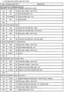

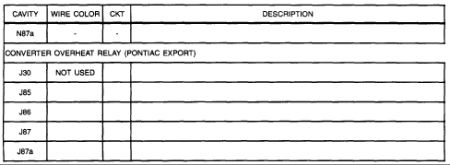

Hello - I have attached the info you requested and also a TSB on the lights. You may have a wiring problem although I think it would have shown up before now. But I included it. To me it may be the light switch itself. You do have the sentimental switch in the correct position don't you? I gave you the head light relay and several fuses for you to check. You may consider checking the fuses with an ohm meter since if they are broken sometimes they are hard to see. The relay I would change if the fuses are good. Last I would consider the light switch itself.
