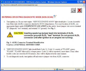

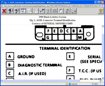

i herd you can do something with the ignition and the service engine soon light to see what is wrong

That's how you get the code's.
