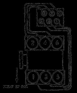

The injector that is 8 ohms is on # 2 . I have a coil off of a 95 cutlass 3.1 will that coil work for a check -- This engine is a 1990 3.3. What is causing the engine to shut off as if you turn off the key?

3.1L (VIN T and M) engine without distributor Firing order: 1-6-5-4-3-2 Distributorless ignition 3.3L engine without distributor Firing order: 1-6-5-4-3-2 Distributorless ignition yes they have the same firing order and derfor should work yes that another way to to test the coil. yes this could make the engine to shutoff too because of lot off unburn gas, computer shutt it off to avoid inondation. you told me you smell lot of gas don't you?

Hello Mathiaso: I don't smell a lot of gas, the gas seems to have a bad smell when I am around the charcoal canister -- The coils on the 3.1 are numbered diffently -- anyway I tried one of the coils off the 3.1 , which is running good, and it didn't help any -- maybe I should try all of them -- I am sure leaning toward PCM being the problem -- I can get a used one from the local saolvage for $40.00 -- maybe it will be worth a try -- had the ign mod checked aagin by a different parts store and it checked good -- I am really stumped on this one --

now, on the coil, swap the cable on the #3 and #6.
I mean put the cable on # 3 to #6 and from #6 to #3.
let me know if the misfire is still on # 3 or have move to #6.

Hello Mathiaso:-- I swapped the wires on #3 and #6 still no fire and also I checked all of them again and now I have no fire on #2,#3,#4,#6 -- it is only firing on # 1 and # 5 --- keeps getting worse. What do you think ?
