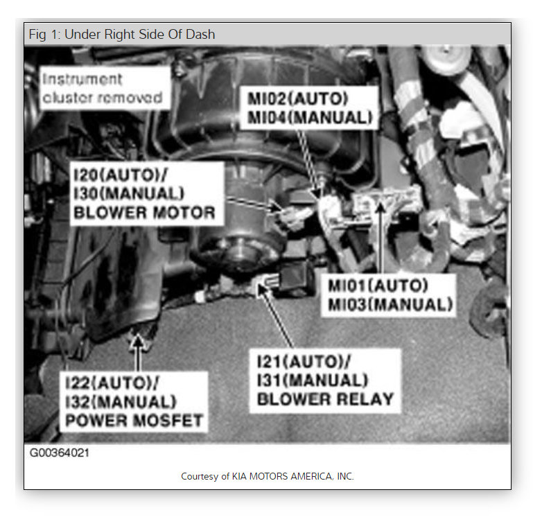

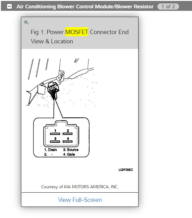

How do I change the blower motor resistor ... I am trying to change my blower motor resistor but I am not sure how to do this or where it is even located .. I know it is on the blower motor but where ??? Do I need to remove blower motor or the glove what ... Is there a simple solution or not can u help or not ?
May 7, 2013 at 6:22 PM
  • CAR REPAIR CONTRIBUTOR
it is next to the blower under the dash it is called a mosfet here is the location in the diagrams below. Check out the diagrams (Below). Please let us know if you need anything else to get the problem fixed.
