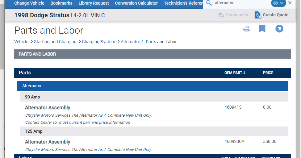

What amp is my alternator? The vin number is 1B3EJ46C8WN206286.
Friday, March 30th, 2018 AT 6:31 PM
Your VIN calls for the 90 amp alternator. The other option is a 125 amp and that is only called for when high load is required and was only a special order option.
Here is a video that will help with testing the alternator is you need this as well:
https://youtu.be/Z-p4dMJUpUw

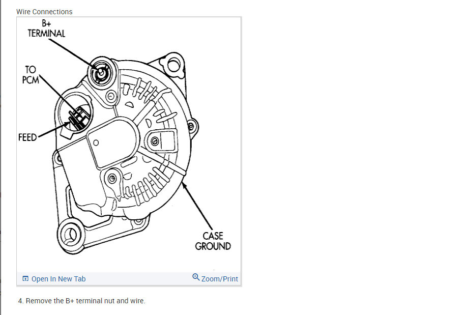

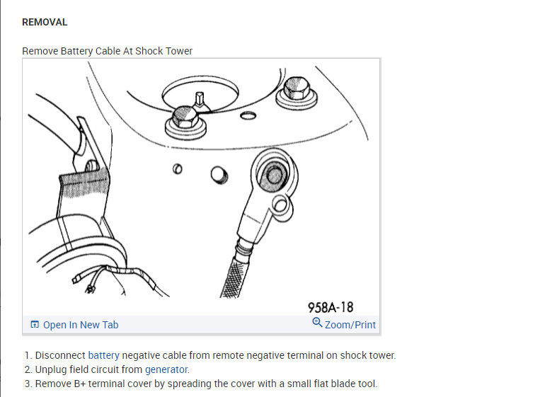

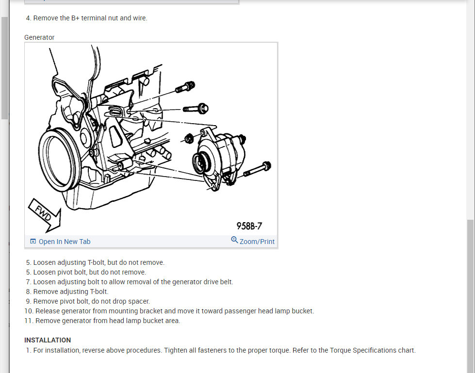

Below you will find the process on how to replace the alternator and part number that you will need.
Please let us know if you have other questions on this. Thanks
