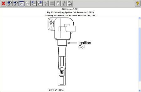

how do you check for bad ignition coil when they sit on the spark plugs
Tuesday, September 2nd, 2008 AT 7:24 PM
KHLOW2008
MECHANIC
41,815 POSTS
Hi tetheodore,
You can measure the resistance to see if it is faulty.
You can only measure the primary coil resistance across terminal 1 and 2.
0.9 to 1.1 ohms at 77 F (25 C).
Replace coil if out of specs.
