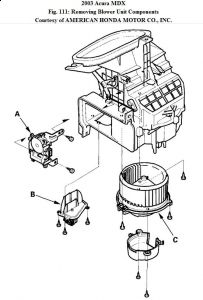

2003 Acura MDX center consel
DJBOWERING
MEMBER
2003 ACURA MDX
Electrical problem
2003 Acura MDX 6 cyl All Wheel Drive Automatic
how do you remove the center consel to get to the
blower resistor?
Wednesday, September 16th, 2009 AT 9:32 AM
KHLOW2008
MECHANIC
41,815 POSTS
Hi djbowering,
You need not remove the center console to get at the blower resistor. It is item " B " in diagram, also known as the power transistor.
Removing the glovebox should do.
