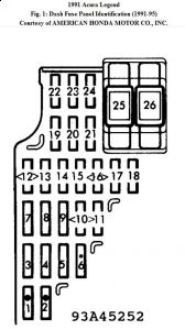

Since the inside fuse cover for my 1991 Acura Legend is missing, i do not know where each fuse goes. So, I need a diagram for the inside fuse box.

Hi 610curtis, Here they are.
https://images.2carpros.com/forum/automotive_pictures/192750_FuseDash91LegendFig01_1.jpg
Fuse & Circuit Breaker Identification "¢ 1 - 15 Amp Foglights "¢ 2 - Blank "¢ 3 - 15-Amp Anti-Lock Brake Motor Relay, Anti-Lock Brake Control Unit, Front/Rear Anti-Lock Brake Fail-Safe Relays, Anti-Lock Brake Inspection Connector, A/C Compressor Clutch, A/C Compressor Clutch Relay, Fan Control Unit, Radiator Fan Main Relay, Radiator Fan Relay, Rear Window Defogger Relay, Rear Window Defogger Indicator Light "¢ 4 - 10-Amp Stereo Radio/Cassette Player, Cigarette Lighter Relay, Cellular Phone "¢ 5 - 20-Amp ECU & EACV Systems, Fuel Injector Resistor, PGM-FI Main Relay, IAC Valve "¢ 6 - Blank "¢ 7 - 20-Amp (1991-92) 10-Amp (1994) SRS System "¢ 8 - 20-Amp (1991-92,94) Not Used 1993 Passenger's Power Seat Belt Presenter, Driver's Power Seat Belt Presenter, Power Door Closer Control Unit "¢ 9 - 15-Amp Cigarette Lighter "¢ 10 - 15-Amp Seat Heater Control Unit, Right & Left Seat Heater "¢ 11 - 20-Amp (1991-92,94) Not used 1993 Power Door Closer Control Unit (1991-92), A/C Compressor Clutch Relay (1994) "¢ 12 - 7.5-Amp Daytime Running Light Control Unit (Canada Only) "¢ 13 - 7.5-Amp Integrated Control Unit, Clock & Gauge Assembly, DRL Indicator Light (Canada Only), Back-Up Lights (A/T), Turn Signal/Hazard Relay, Passenger's Seat Belt Tension Reducer, Shift Lock Solenoid (A/T), Driver's Seat Belt Tension Reducer, Back-Up Lights (M/T) "¢ 14 - 7.5-Amp ECU & ECU Main Relay, Gauge Assembly (Bulb Check Circuit), Starter Solenoid "¢ 15 - 7.5-Amp Voltage Regulator, ECU, Fan Timer Unit, Security Control Unit, Power Seat Control Unit, Driving Position Memory System, Charging System "¢ 16 - 20-Amp Daytime Running Light Control Unit "¢ 17 - 20-Amp Driver's Power Window Switch, Power Window Control Unit "¢ 18 - 20-Amp Right Front Power Window Motor "¢ 19 - 7.5-Amp Automatic Climate Control Unit, Function Control Switch, Recirculation Control Motor, Blower Relay, Blower High Relay, Power Door Mirror Actuators, Door Mirror Defoggers, Seat Heater Relay (Canada Only), Mode Control Motor, Maximum Cool Control Motor "¢ 20 - 7.5-Amp Cruise Control Unit, Fan Timer Unit, Security Control Unit, Power Seat Control Unit "¢ 21 - 20-Amp Left Rear Power Window Motor "¢ 22 - 20-Amp SRS System, ECU Main Relay, Charge System Light, Voltage Regulator, Speed Sensor, Left/Right Heater Oxygen Sensor, Purge Control Solenoid Valve, Traction Control System (1994) "¢ 23 - 7.5-Amp Windshield Wiper Relay, Washer Motor, Integrated Control Unit, Sun Roof Relay "¢ 24 - 20-Amp Right Rear Power Window Motor "¢ 25 - 30-Amp ECU Main Relay, Ignition Coils, Noise Condenser "¢ 26 - 30-Amp Windshield Wiper Motor

Thanks KHLow2008,
This is what I needed.
