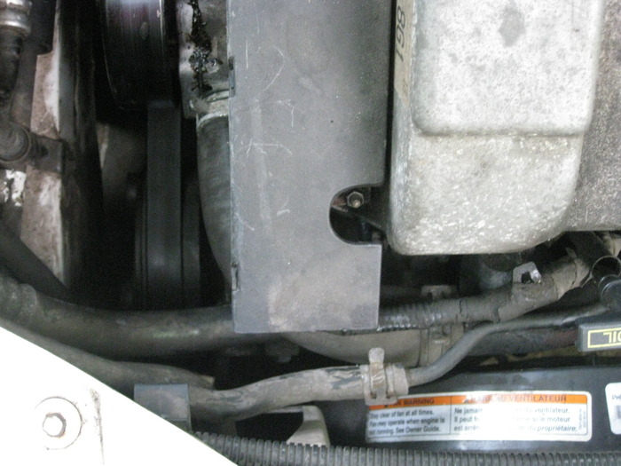

The pressure was 90/90 on both sides. The person at Valvoline, believes it's coming from the side of the compressor clutch that faces the fender wall. It holds vacuum and pressure, but leaked out almost all the R-134A from somewhere, presumably under pressure when the compressor was turning...
They figure I should replace the compressor, which entails replacing the Orifice tube and Dryer. Normally I would do that, but in this car, it's so tight, and basically you have to remove the water pump again in order to get the silly thing out. Not to mention the dryer where it sits, doesn't look like it's easy to remove, without breaking a metal hose.

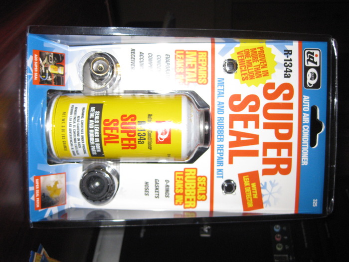

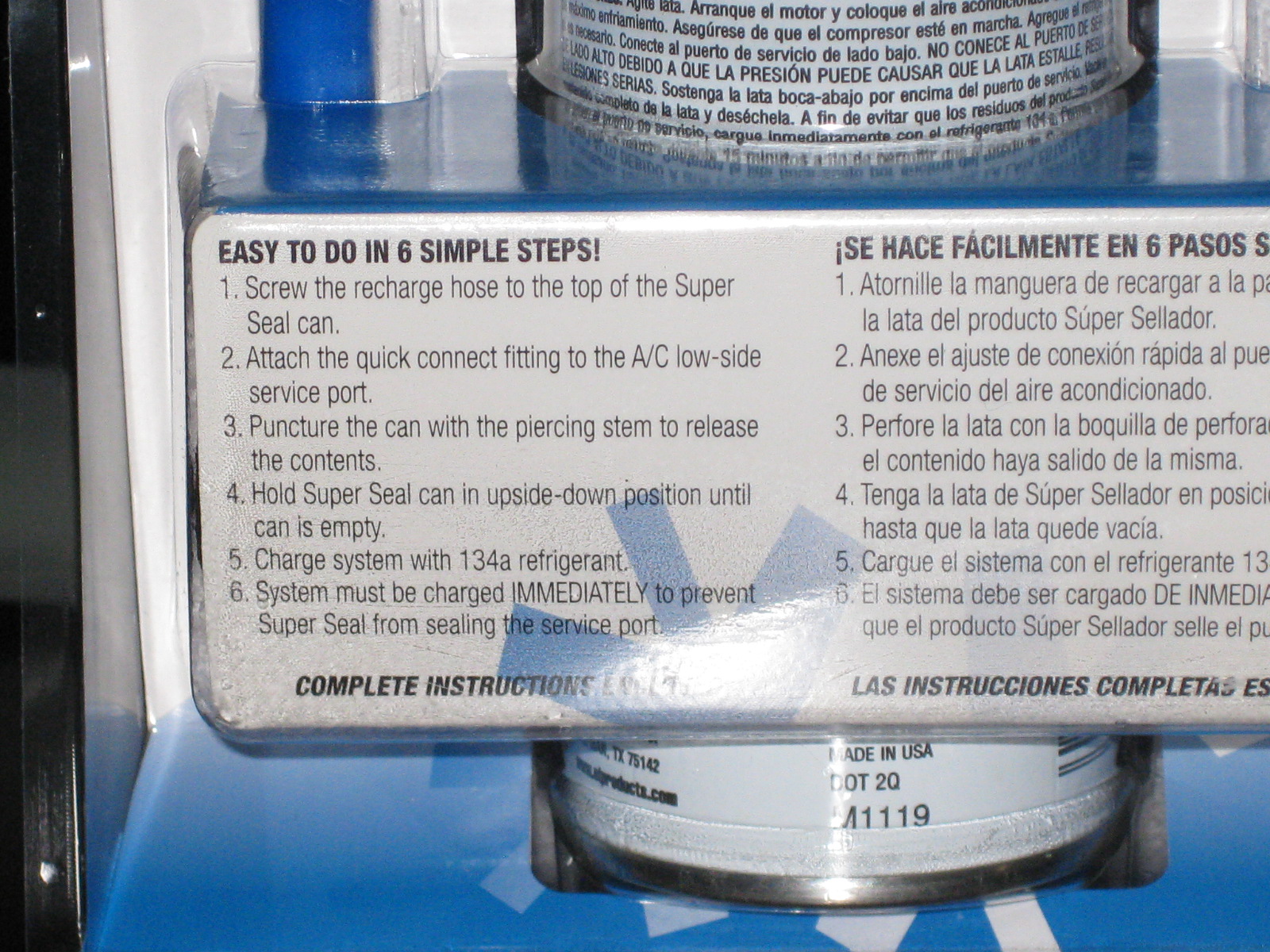

So then I came upon this stuff today, while I was at Autozone. I thought I'd ask your opinion on this, as I found out later the Tire Seal I used once is a disaster inside once you use it to fix a leak, then later go to replace the tire.
If you notice #6 it says you must immediately charge the system or the stuff will seal over the port.
What are your thoughts on this. The AC worked, right up until the fluid leaked out again.

For compressor removal, here are some tips. They are different from the shop manual
Loosen the top two bolts of the compressor. It's a little tight but you can do it. Next take the belt off. Lift the car, drain the radiator, take the lower hose off,take the hose above the lower hose off(the metal one). Next take the two sub frame bolts out(put a jack
under it first) on the passenger side. Lower the frame take the two bottom compressor bolts out. Then the top two bolts loosen them the rest of the way out but leave them in the compressor. Lower the compressor remove the manifold bolt and its out.
Jul 18, 2012 at 3:31 PM

I have never believed in repairing seal for leaks. system is under pressure and if seals are bad, I don't understand they can work. Temporary fix maybe but how long will it last?
System has minute passages so there is a possibility the checmical might block them.

I just did the water pump too, so at least it's loose, I thought when I was doing it, wow this gives for easy access to the compressor.
I wasn't too keen on that substance. Notably I've seen what happens inside a tire after that green flat substance is used, and it's a mess.

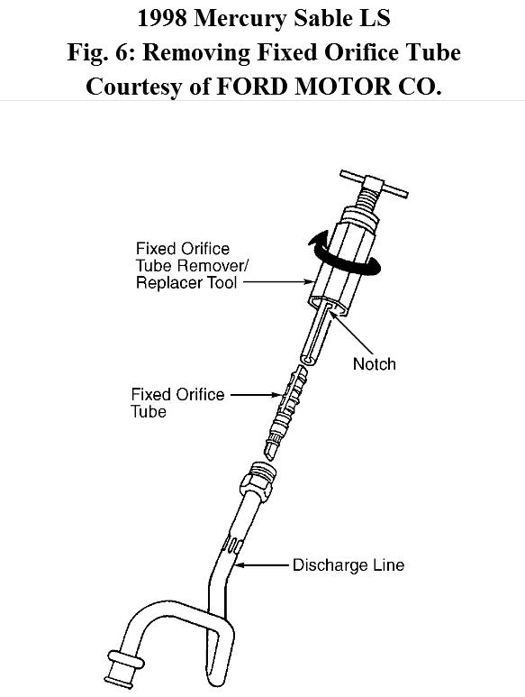

Ought to be fun doing the dryer can. I hope the Orifice tube is somewhere in this area.

It is in the discharge hose.

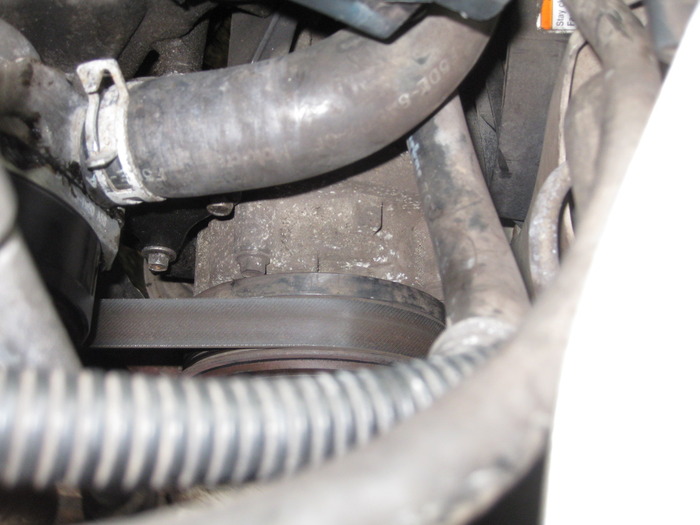

I'm still questioning the diagnosis. Have you ever heard of it leaking out the side of the compressor by the Clutch bearing?? It just doesn't seem feasible to leak there. And I'm wondering, if that's the case, wouldn't be easier to just simply replace the clutch for $50 than the whole dryer/compressor/orifice tube for $350. The compressor does work when it's charged.
Jul 19, 2012 at 3:24 AM
KHLOW2008
  • CAR REPAIR CONTRIBUTOR
  • 41,814 POSTS
Yes, it is possible for leakage to occur at the shaft seal behind the clutch bearing. I did encounter a case whereby leakage was from the seal and you could not detect the leak when compressor is not working. It leaks minimally when fully charged and when the pressure drops to a certain level, it would leak faster. It would suddenly stop leaking when pressure drops to a certain level whereby the seal is able to hold the pressure.
The seal is not at the clutch so replacing it would not work. It is on the compressor main body at the mainshaft that holds the clutch plate.
