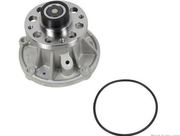

Can you see how high the leak is coming from? Your fan attaches to a bell like pulley, right behind that is your water pump (I will add a picture for you).
There is an O-ring that seals it, and it is very thin. It seems to me the pump or the O-ring has failed.
The fan is attached directly to the water pump. Usually fans only work under about 40 MPH. After that there is enough air moving through the radiator to cool the engine.
So, it's possible you didn't hear it on the way home because you were above or around that speed putting less strain on the defective pump. But that's a nasty sound I personally wouldn't drive it.

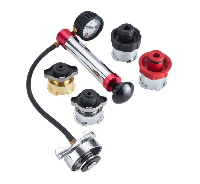

First: Go to your local parts store and rent a "Coolant Pressure Tester" or you can buy one at Harbor Freight as well. Also grab some brake clean maybe 4 cans and plenty of rags if you don't have any. Grab some coolant while you are there as well. Make sure it is equivalent to the yellow for stuff. If they sell Motorcraft I would just buy that. You don't want to be mixing coolants.
Second: When you get home let the truck cool down and use the brake cleaner and rags to clean all the coolant off the motor and other surfaces and let it dry.
Third: Top off the coolant squeezing the hoses to get the air out of the system. Then using the adapter in the kit, attach the pressure tester to the adapter, then to the where the radiator cap goes. (You may not need an adapter) Make sure you get a good seal.

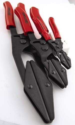

*If there is an overflow house make sure to use some hose pliers or locking pliers and a rag to pinch the house closed so the pressure won't leak out the system. *
(I have added a picture of the hose pliers I use myself)
Fourth: Make sure you have a really good flashlight and pump the tester to about 15psi. The hoses should be tight. Check your radiator cap for your system's rated pressure and go by that. Usually, it is between 13-15 PSI.
Fifth: Starting from the top of the motor looking up from the bottom, see if you can see coolant starting to leak. Look particularly at the bottom of the water pump area (center top). Also check all hoses, and their connections.
Let me know what you see. Also be patient as it might take a bit to start leaking.
I have added images of the tester as well as a link to a video on pressure testing:
https://www.2carpros.com/articles/radiator-pressure-test
Let me know what you find, and we can go from there.
