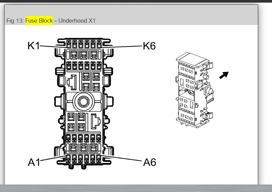

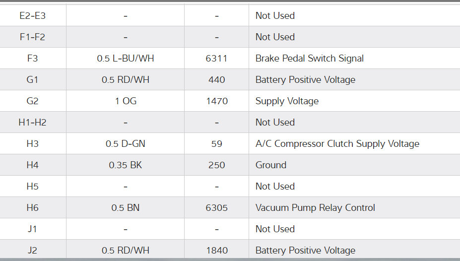

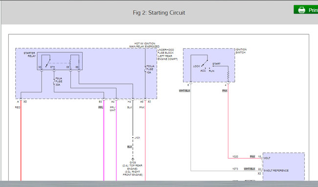

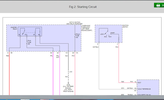

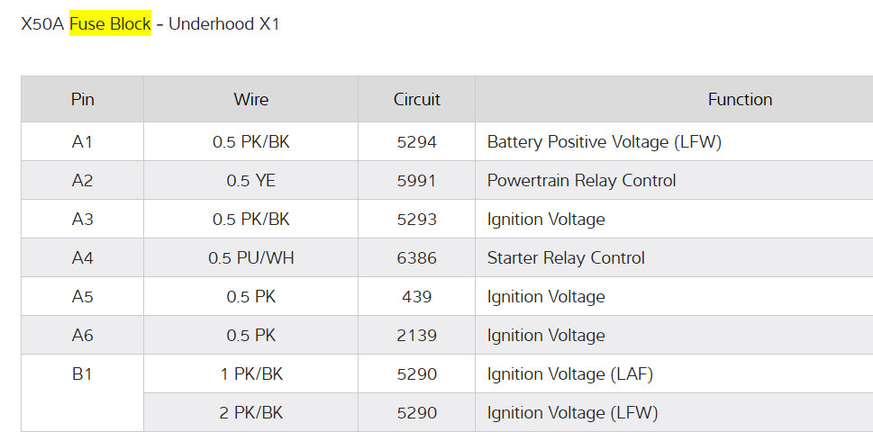

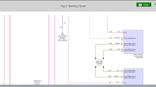

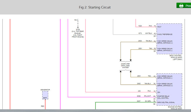

Okay, can you check and see if you have battery voltage at pin#87 of the starter relay? The relay is located in the under-hood Fuse Block at the left rear of the engine compartment. I have included in the diagrams below a Starting Circuit Wiring Diagram and a diagram of the under-hood Fuse Block. I have also included a link below of how to use a multi-meter below if you are not familiar with how to use one.
Please go through these guides and get back to us with what you are able to find out.
Thanks,
Alex
2CarPros

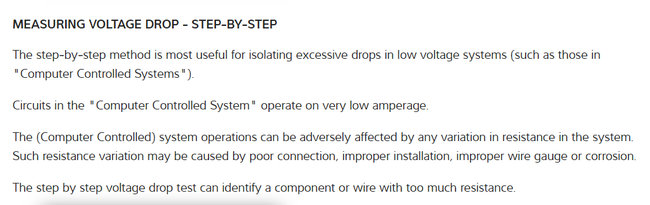

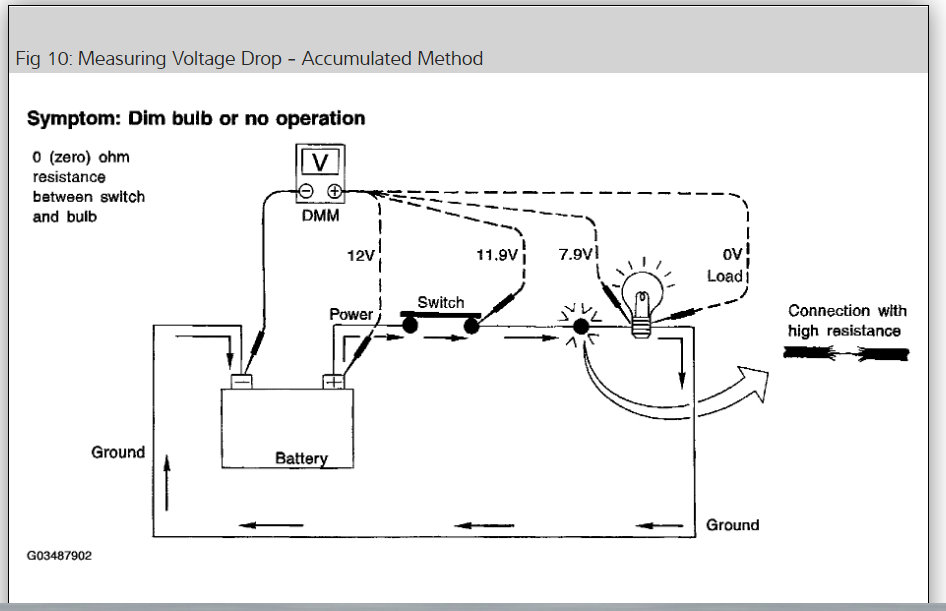

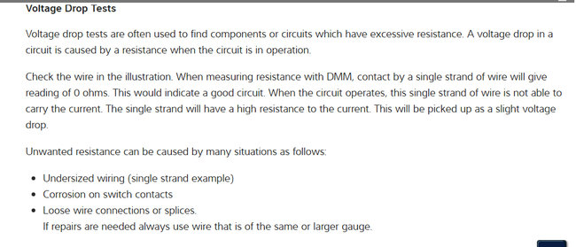

Hello again,

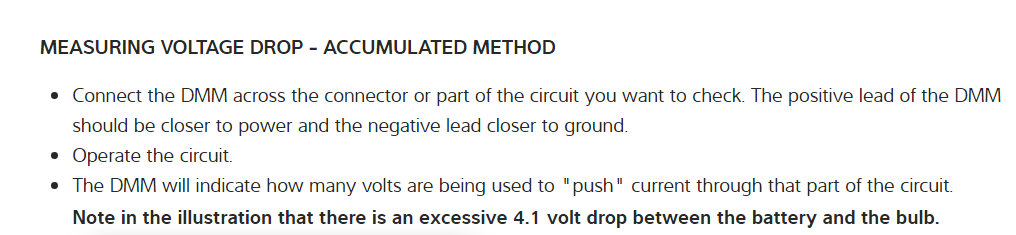

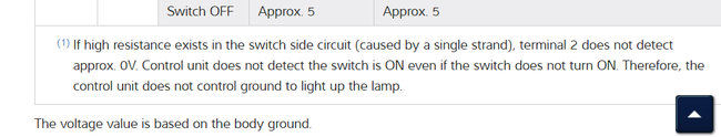

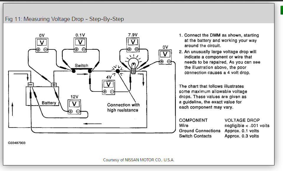

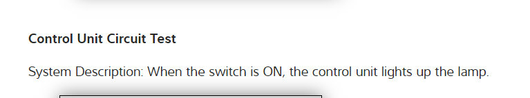

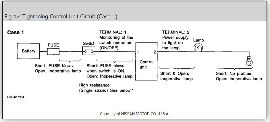

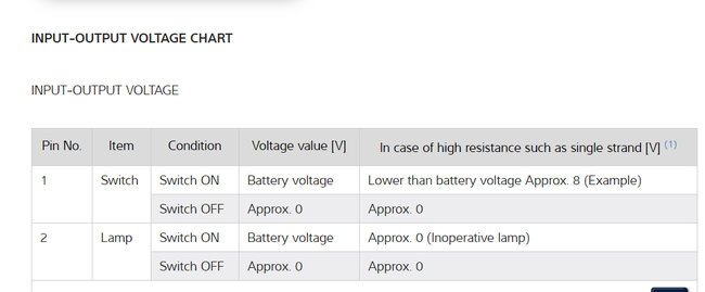

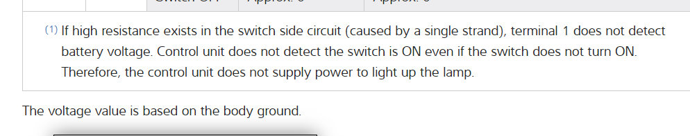

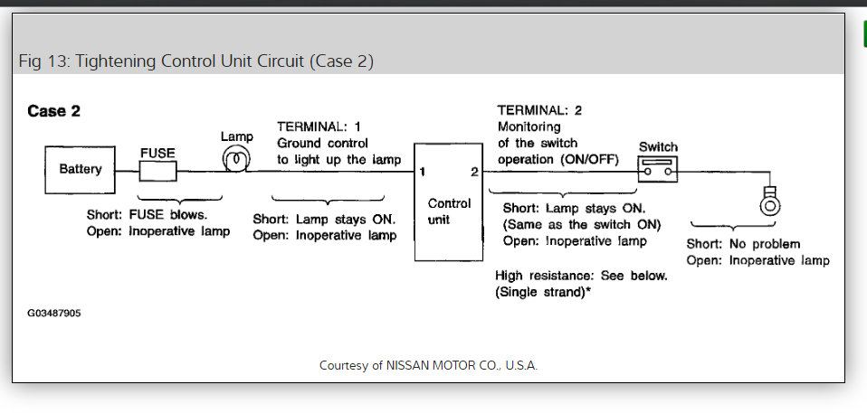

That is because you are getting massive voltage drop along the way. The starter motor is only getting about half the voltage it needs to operate properly. You are going to need a new starter solenoid and the wires are going to need to be cleaned up, or better yet replaced. Voltage drop is caused by unwanted resistance in an electrical circuit that takes up voltage for the electrical flow to push past it leaving an under-volt condition when the electricity gets to the load. I have included information explaining voltage drop in the diagrams down below. Please get back to us with how it turns out.
Thanks,
Alex
2CarPros
Apr 29, 2019 at 1:48 PM

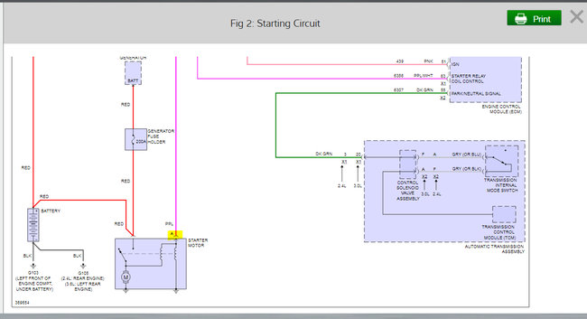

Okay,

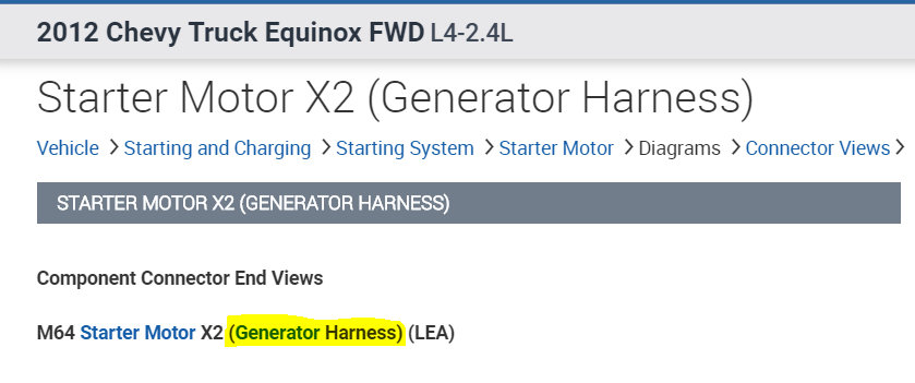

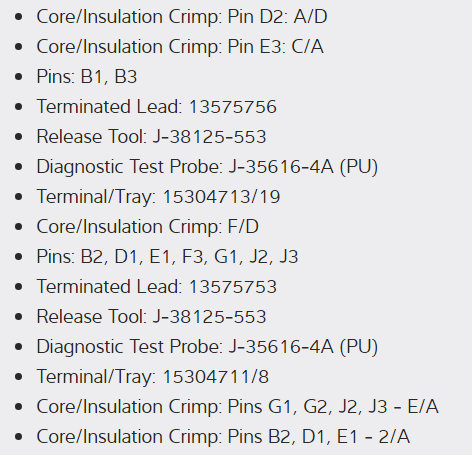

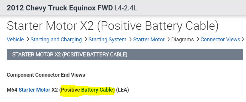

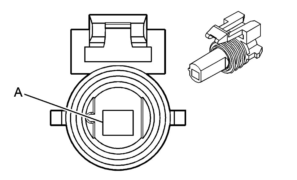

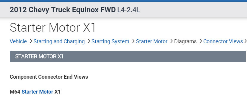

I'm sorry, I misunderstood what you were saying earlier about the voltages and where the voltage drop was. So we are both on the same page, I have included for you in the diagrams down below a diagram of the connections on the starter. The one I want you to get a reading on with your multimeter is connection X1. I need the voltage there when the engine is cranking, please. I have also included another Starting Circuit Wiring Diagram, which I will include every time we test something new, with the pin that we are testing highlighted. Let's test this one and see where we are at.
Thanks,
Alex
2CarPros

I’m sorry it’s taken so long, I’ve been out of town for work. The voltage is 11.4 when the key is in the start position. When I check voltage from the battery to the solenoid it shows 11.4 volts. But again, if I check from the solenoid to the starter while the key is in the start position it only shows 4.5 volts. I’m thinking my starter is bad?
