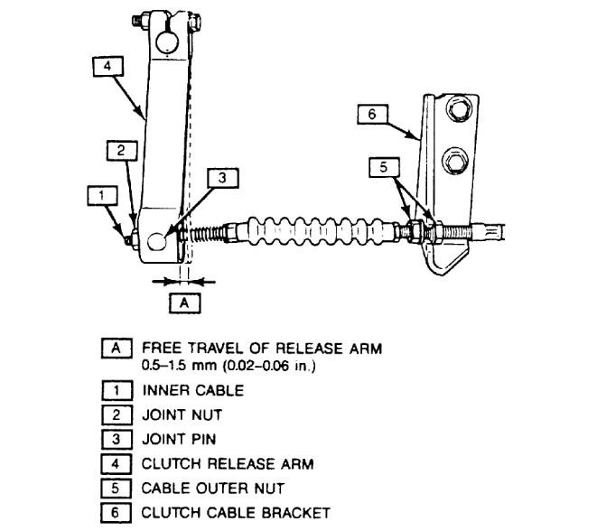

Good afternoon,
Yes, it could be a clutch issue but does the clutch pedal feel any different fro before?
This could be a bad cable from the clutch pedal to the transmission. You can try adjusting the cable to see if it helps. I attached the procedure for you.
