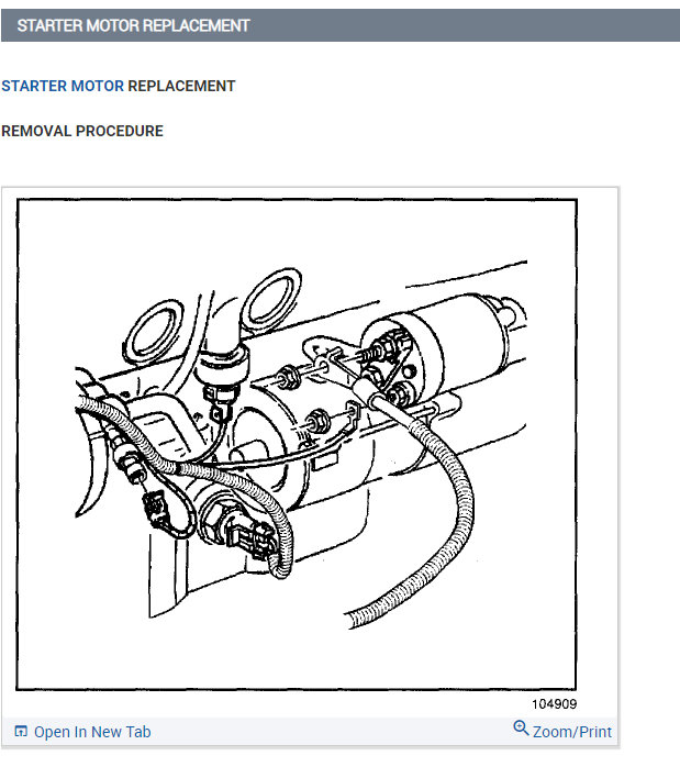

i'm not sure what's going on, after i drive my car and get out for like 10-20 minutes or up to an hour, i get back in and try to start it and it makes a weird electrical sound like it cranks over halfway then sounds like it's going to not start then it comes back on. i have gotten a new battery, new plugs and wires, new fuel pressure regulator, new fuel pump assembly. I don't know what the problem is and it's the only thing keeping this car from being good. after it happens i can drive the car normally. and it never happens in the morning or like when its been sitting overnight. it's always after i drive it. so maybe its a problem when its hot? here's a video with it happening so maybe you can try to listen and detect?

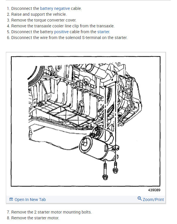

Thanks for the video! very helpful! So i would highly recommend taking vehicle while it's hot and acting up to a shop to have the starter tested. sounds like when the starter gets hot it is starting to seize some. Here is starter location and replacement procedure.

Yes, I watched the video. If you installed spark plugs incorrectly you would know it right away. The engine would run rough or make noise constantly. Yes, I have seen the starter do some similar things and other weird things. I would definitely take it and have the starter and battery system checked.
