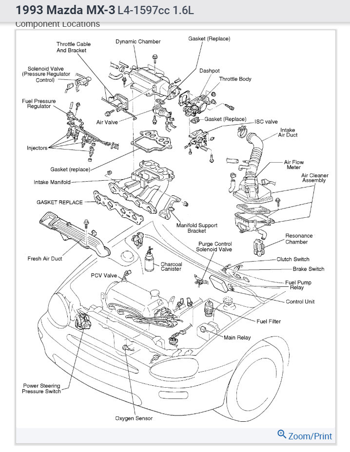

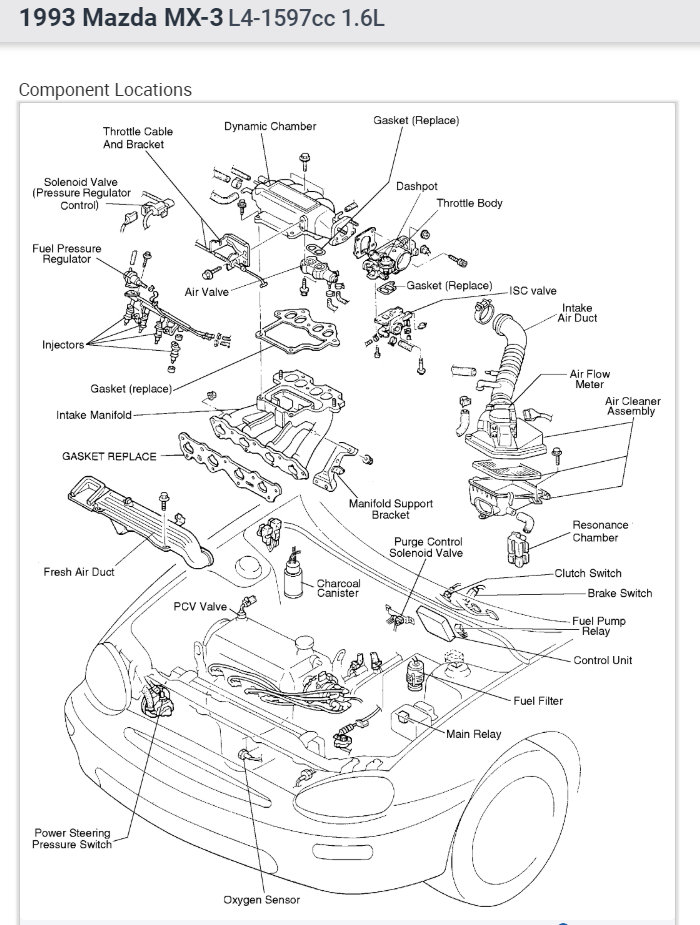

The diagram of the car you posted is for a six cylinder car. Would you possibly have one for the 1993 1.6l 4 cylinder car?
Sep 8, 2018 at 9:58 PM
  • CAR REPAIR CONTRIBUTOR
  • 54,334 POSTS
Opps, here is the diagram for the four cylinder but I do not see the location. It should be near the thermostat housing.

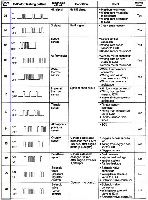

Okay, I checked the codes again, nine blinks, coolant sensor. I have changed the coolant sensor three times and changed the plug. Some other site said to cut the plug off and twist the wires on the harness side together, if the check engine light goes off then the problem Is the plug. Well that did not help, the check engine light is still on even with the wires twisted together. Still getting nine blinks after clearing codes. Motor still sputters and hesitates with coolant sensor plugged in and unplugged the motor has immediate throttle response but starts to fall on its face about 3/4 throttle. So what next?

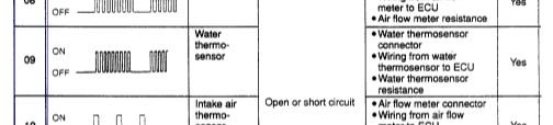

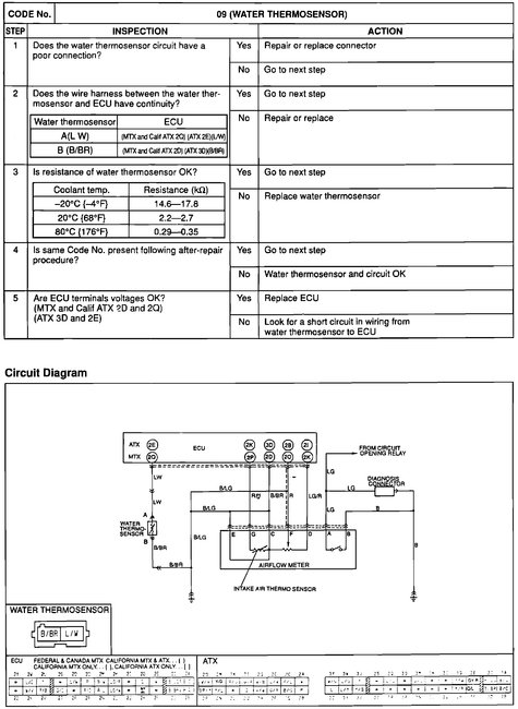

The code you have indicates there is either a short or open circuit. Chances are there is either a broken wire (bad connection which you already checked) or the wiring to the PCM is damaged. I have attached the flow charts for testing this circuit. If you are unable to enlarge the pictures or cannot read them, let me know.
Picture 1 shows the code and its meaning, two is cut from the page which explains what could be the issue, and three is the flow chart and wiring schematic.

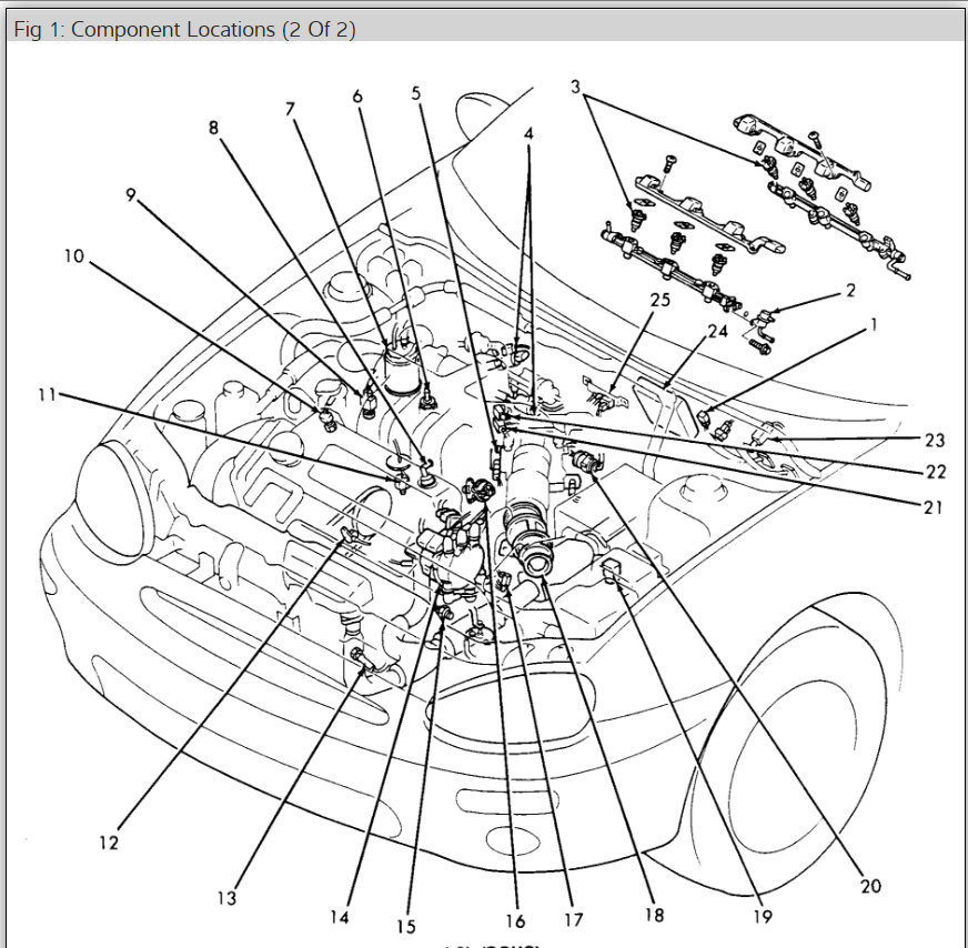

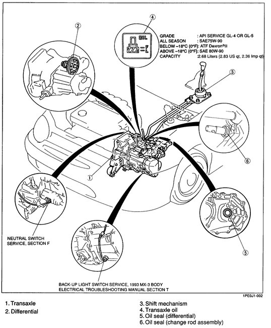

I have checked three coolant sensors all out of the vehicle, two were used and the third was brand new out of the box. All three were the same temperature, all three had the same resistance. I have checked all the vacuum lines, no leaks. I do not think the brake booster is leaking either. I step on the brake and the RPM'S drop maybe just a little. I am about at wits end. I have never had a car out smart me until now. It shows no codes, yet does not run like it should. It will not start cold unless the coolant sensor is plugged in, it will not run half way decent unless it is up to operating temperature and coolant sensor is unplugged. Otherwise with it plugged in and motor is at operational temperature if you step on the gas the motor completely cuts out until you let off the gas completely, then it goes back to idle speed. When it is cold and you go to start it with the sensor plugged it will start on the second try, idle goes up to 1,500 rpm, idles smooth, then starts to drop after about ten seconds and shuts off unless I barely tap the accelerator. I have to tap it about five to seven times and then it will idle roughly. Once the temperature gets up I unplugged the sensor and I can drive it. It does not run great but well enough to get around. I tried plugging it in while it was warm and it acts intermittently like it wants to run like it used to but then it goes back to misfiring and cutting out. I took the throttle body off and cleaned the bore and took the air idle off and cleaned it good. Checked the resistance on the air idle it is within specs, checked the throttle position sensor its working fine. My next move is fuel pump and filter and fuel pressure regulator. There are two sensors on the manual transmission, one is on the passenger side of the transmission and has had the wires broke off would that be causing all this? My reverse lights work as well as the clutch safety switch. What is that sensor for?
Oct 18, 2018 at 3:25 PM
  • 110,190 POSTS
Welcome back:
The component you are referring to is the neutral switch service. I cannot see how it could be causing this issue. See the attached picture.
If the fuel pump pressure is within the manufacturer's specs, a new one wont make a difference.
You mentioned a code 9. Either you have a short in the ECT wiring or a wire is broken and no signal is being sent to the ECU. I hate to say it, but it is time to start tracing wires to see where that issue could be. Make sure the pins at the ECM are clean and not corroded, bent, or pushed into the plug. If it all is good, you need to check continuity for an open or a short.
I have attached a diagnostic flow chart for this problem. Follow it step by step. It is picture 3. Let me know what you find or if you have other questions.
