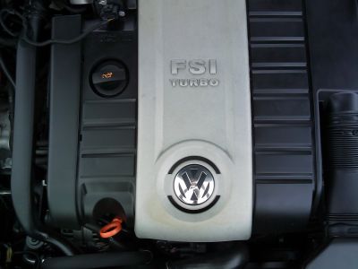

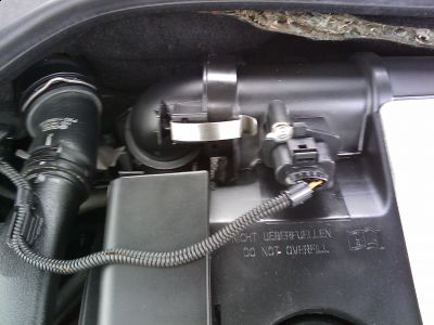

hi,
I REPLACED THE PLUGS WITH IRIDIUMN, CHANGED THE AIR FILTER. PUT IT ALL BACK TOGETHER AND IT STARTED. I TOOK IT FOR A SHORT TEST DRIVE AND IT STARTED SKIPPING. I GOT IT HOME (LESS THAN A MILE TOTAL) BY THE TIME I GOT HOME AND LOOKED UNDER THE HOOD I SAW AND SMELLED SMOKE. I HAD FRIED THE 1ST COIL. I REPLACED IT AND I DO HAVE POWER, BUT NONE TO THE PLUGS. I DO NEED TO TELL YOU THE REASON FOR THE FRYING IS I FORGOT TO PLUG IN THE CONNECTOR WIRE ANT THE BACK LEFT SIDE WHERE THERE IS A CLAMPED HOUSING, I WOULD IMAGINE FOR VENTILLATION. INSIDER THAT HOUSING ON THE REMOVABLE COVER IS A SENSOR. THE SHORT OF IT IS I HAVE CK ENGINE LIGHT AND KEY SENSOR LIGHT IS ON THE DASHBOARD. I THINK IT JUST NEEDS TO BE RESET? PLEASE ADVISE.

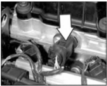

Hi Ron, Thank you for the donation. There are many variants of the engine and each has different layouts so I would need you to provide me the details. 1. Engine capacity. 2. Turbo. 3. Number of cylinders. 4. Is it possible to attach a photo of the sensor that you are refering to? I suspect it to be the camshaft sensor. I have a pic of the cam sensor for a 2.5, is it the same?
https://images.2carpros.com/forum/automotive_pictures/192750_CamSensor06Jetta25_1.jpg
Since Check Engine Light (CEL) is on, you would need a scanner to retrieve the Diagnostic Trouble ( DTC) code to verify source of problem.

IN REPLY THANK YOU FOR YOUR ASSISTANCE! SORRY ABOUT THE MEGAR DONATION, BUT THAT'S ALL I HAD AVAILABLE ON MY BANK CARD. ITS A SHAME I KNOW. HOWEVER, I HOPE THE ABOVE INFO IS HELPFUL. THE PHOTO PROVIDED IS NOT THE SAME AS MY SETUP, BUT I BELIEVE YOU ARE RIGHT. THERE ARE CODES THAT NEED TO BE CLEARED IN ORDER TO GET THE ENGIN RUNNING RIGHT. I AM HAVEING IT TOWED TO VW IN THE MORNING AND I JUST HOPE THAT I DIDN'T FRY ANYTHING ELS. I DID THINK THAT THERE WAS SOMETHING THAT COULD BE DONE TO RESET EVERYTHING WITHOUT THE DEALER COMPUTER. I DID WATCH A MECANIC RESET THE COMPUTER BY USING THE KEY, GEARSHIFT AND CLUTCH, BUT I CAN'T REMEMBER THE SEQUENCE.
